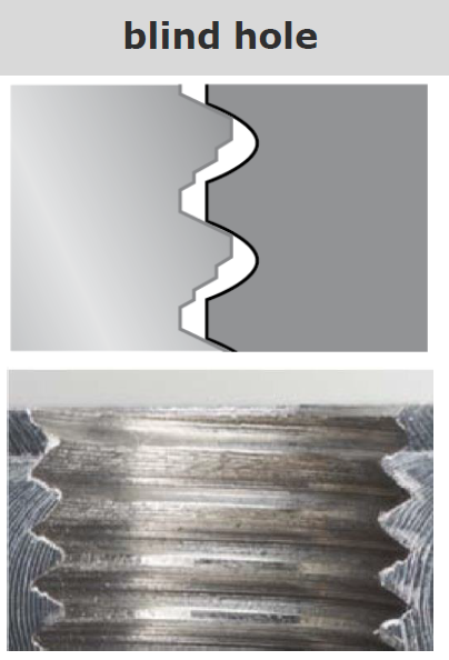

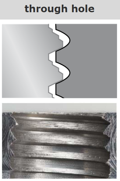

If a floating holder is being used, it is possible to have axial mis-cut due to the movement that is allowed.  Axial mis-cut occurs when the cutting forces acting on the tap try to move the tap at a different rate than the machine is feeding.  It works in opposite directions when comparing spiral point and spiral flute taps.
Spiral point taps have the cutting forces pushing up on the tap. As a result, the cutting forces are preventing the desired rate of movement into the part.  This creates a case where the tap re-cuts the top part of the thread profile creating an unacceptable surface and an oversized thread pitch.  The oversized thread pitch allows the no-go gage to be threaded into the part.
Spiral flute taps have the same condition in the opposite direction.  The cutting forces are trying to pull the tap into the part faster than the desired rate of movement.  This causes the axial mis-cut to occur on the bottom side of the thread profile.  However, it has the same result as when it occurs in the spiral point tap: the thread pitch diameter is oversized which allows the no-go gage to thread into the part.
The first action is to make sure the tap being used is appropriate for the material.  If the cutting geometry is not designed to work in the material, it could cause the axial mis-cut situation to worsen.  Characteristics such as the coating or helix angle should be optimized for the material.
It is also possible to reduce the feed rate to 90%.  This will ensure that the floating holder is under constant tension.  Having the floating holder under constant tension will minimize the amount of movement and stabilize the tool reducing the ability for mis-cut.
Finally, if the machine spindle and controller have the capability, switch to rigid tapping.  Most modern machine tool spindles have the capability to rigid tap.  Floating holders or full tension/compression holders are not always necessary.  If it is possible to not use these holders that allow movement, the axial mis-cut condition can be avoided completely.
