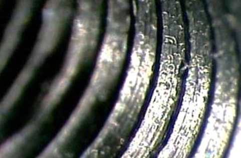

Poor surface finish
The quality of the surface finish produced on internal threads could be poor enough to make the thread out of spec. The part could have a specific surface finish requirement that must be met. Or the surface finish could be so poor that it actually affects the way the  go gage threads into the part. Either way, there are corrective actions that can be taken to improve the surface finish.
Poor surface finish could be so bad that it actually causes the go gage to not properly thread into the part.
Built Up Edge (BUE) is typically the number one problem causing poor surface finish.  It can also cause the tap to cut the thread pitch diameter oversized. This problem was addressed in the previous article. Please reference that article for troubleshooting suggestions.
The wrong cutting geometry, for the particular material being machined, could also cause poor surface finish, either too sharp, or too negative. In a previous article – Tap Performance Troubleshooting – Part 2: Chip Control – multiple changes were highlighted that would help control the chip. However, most of these changes can have a negative effect on surface finish. A careful balance of feeds and speeds needs to be achieved so that consistent process reliability can be maintained. Using an online resource to optimize these cutting parameters is typically a good place to start.

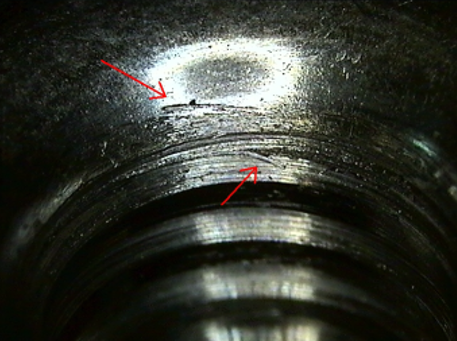

Burr at entry of thread
Rolling a burr on the top side of the threaded hole could cause the  go gage to not enter the thread, even though a good thread was produced. If the top of the hole is not chamfered prior to tapping, adding one will help correct this problem. Chamfering the top of the threaded hole is generally a good idea anyways. Not only does it help correct this problem, it also improves tool life and the overall quality of the threaded hole. There are even tools available to add chamfering capability to standard solid carbide drills so that cycle time and tool changes are not affected.
Burrs at the entry of the threaded hole can typically be resolved by adding a simple chamfer to the top of the hole before tapping
If the top of the hole already has a chamfer and the process is still generating a burr at the top of the hole, the quality of the chamfer may not be good enough. The chamfer could be uneven or not centered on the hole. Ensure that the chamfer is centered evenly on the predrilled hole. If this still doesn’t correct the issue, try varying the included angle of the chamfer. It may be possible that the chamfer angle is conflicting with the lead in angle of the tap chamfer area and is causing a burr to roll.

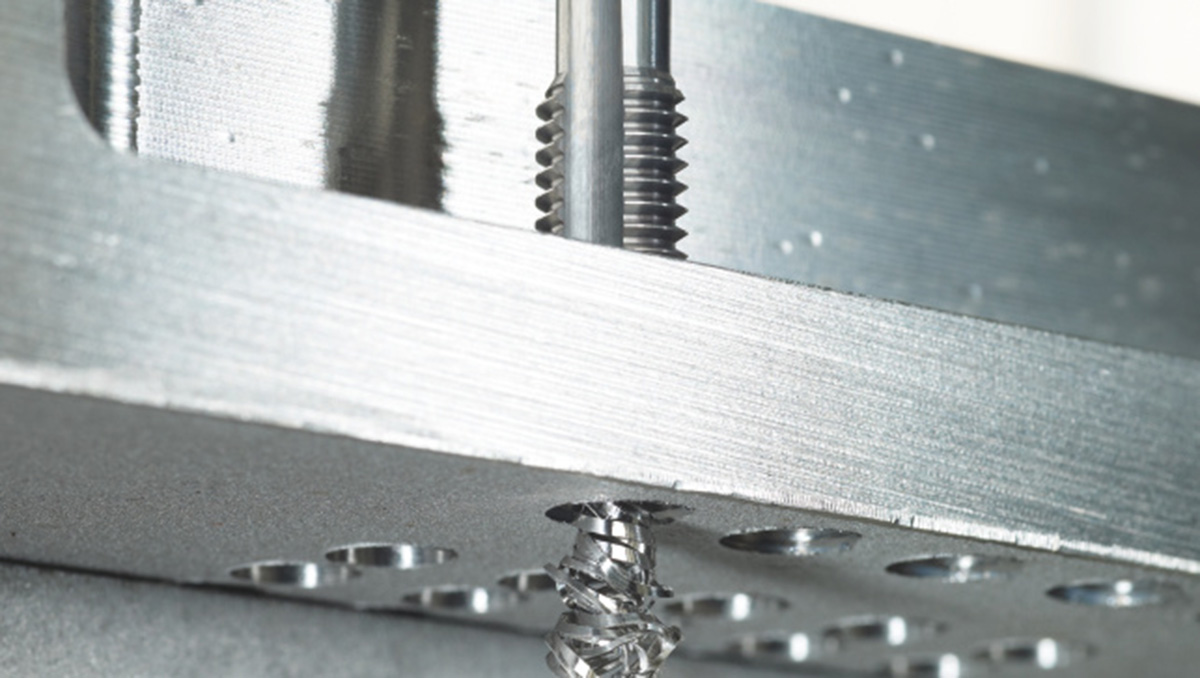

Burr at exit of thread
If a through hole is being tapped, it may also be possible to get a burr at the exit of the hole. The first thing to check here is when the burr shows up. After using the tap drill, check to see if the burr is there. If so, then it is obviously caused by the tap drill and it should be addressed there. If not, then it is most likely created by the tap. In this case, the exit hole should be chamfered after the tap drill. The same quality check should be considered regarding the size and shape of the chamfer as was discussed above when talking about the burr at the entry of the thread. Finally, it could be simply caused by a worn tool. Corrective action would be to replace the tool with a new one which has a clean, sharp cutting edge. Check out the previous article titled Tap Performance Troubleshooting – Part 1: Insufficient Tool Life, to learn how to prolong tool life.
