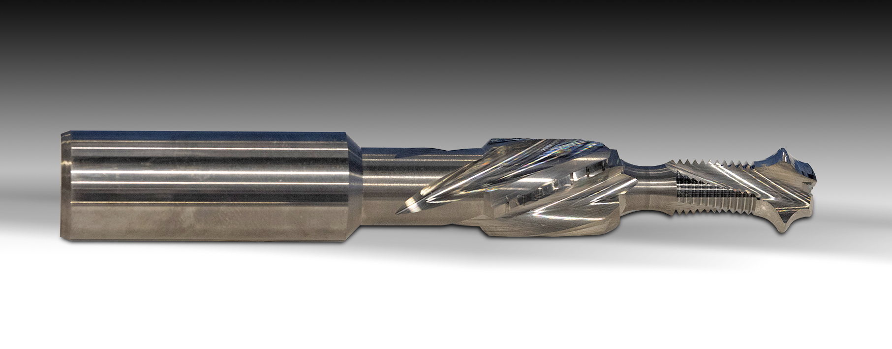

The idea behind the 2022 entry was to combine multiple tools into one and show what ARCH Cutting Tools could do for customers and what an ANCA tool grinder could produce. The creation of this tool played on the aspect of teamwork and brought in players from multiple ARCH facilities.  One of these was Charles Montgomery, CNC Programmer at ARCH Cutting Tools Mentor, Ohio location. Montgomery’s design was chosen as the Tool of the Year entry. The tool was then sent to the Latrobe, Pennsylvania location. Jim Gray, the Regional Director of Operations, programmed it, made the ToolDraft print and manufactured it on an ANCA MX7 grinder.

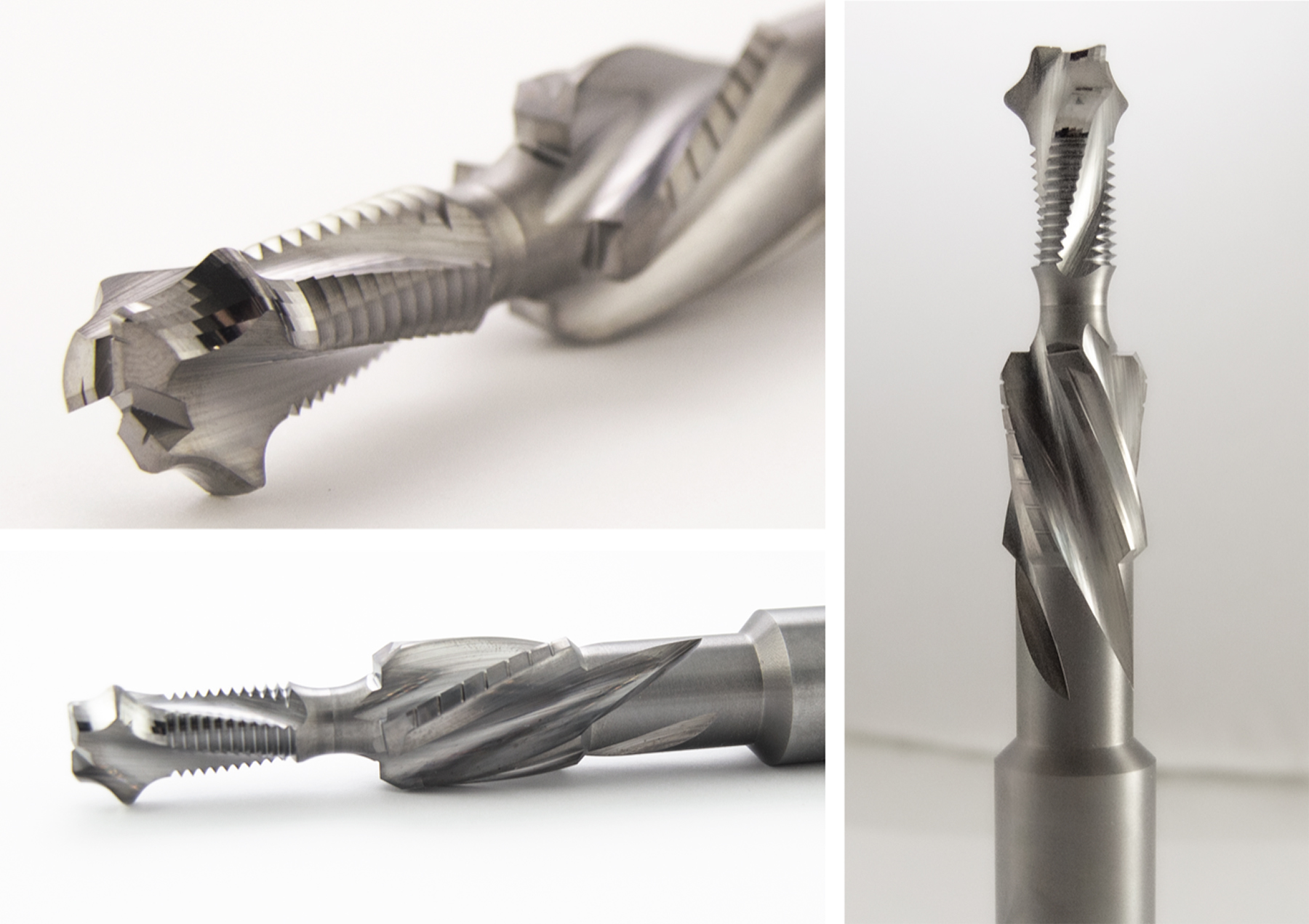

Montgomery described the tool process starting with the tip of the tool as a three-flute right-hand helix endmill with chip breakers, to help stop the tool from creating long chips.  Next, it moves into a three-flute form radius cutter for form milling, then transitions into a threadmill.  This can be used to create internal and external threads of different sizes. A concave spin grind was added to create relief for chip flow and ejections.  Lastly, the back portion changes to a left-hand helix right hand cut reamer to change the forces down into the part to keep it stable in the fixture.  Known as the “Fiver,” due to its multiple functions, Gray said that “ARCH Cutting Tools is a solution driven specialty tool company that provides solutions like this tool that cut down on the end users cost in tooling and cutting cost in production.”
This tool was first designed and programmed using the ANCA iGrind software. Next, ARCH used an ANCA MX7 with special wheel packs to grind the tool for their submission.  Explaining the complexities in design and production, Montgomery said, “It can be a very complex process to design a tool with multiple functions.  You need to use the full capabilities of the software and hardware available, making sure you have all the correct wheels and clearances to avoid any machining issues.”
ARCH Cutting Tools had multiple submissions they prepared for the Tool of the Year contest and company personnel voted on which entry to submit.  The tool was made to showcase the capabilities and complexity that ARCH and ANCA could achieve together.  The “Fiver” took second place in last year’s competition.  Gray mentioned the company’s great partnership with ANCA stating, “ANCA’s ingenuity and advanced technology have given our company the competitive edge that goes along with the expertise of the ARCH team.  ANCA and ARCH have a true partnership in the cutting tool industry…The A-Team.”
