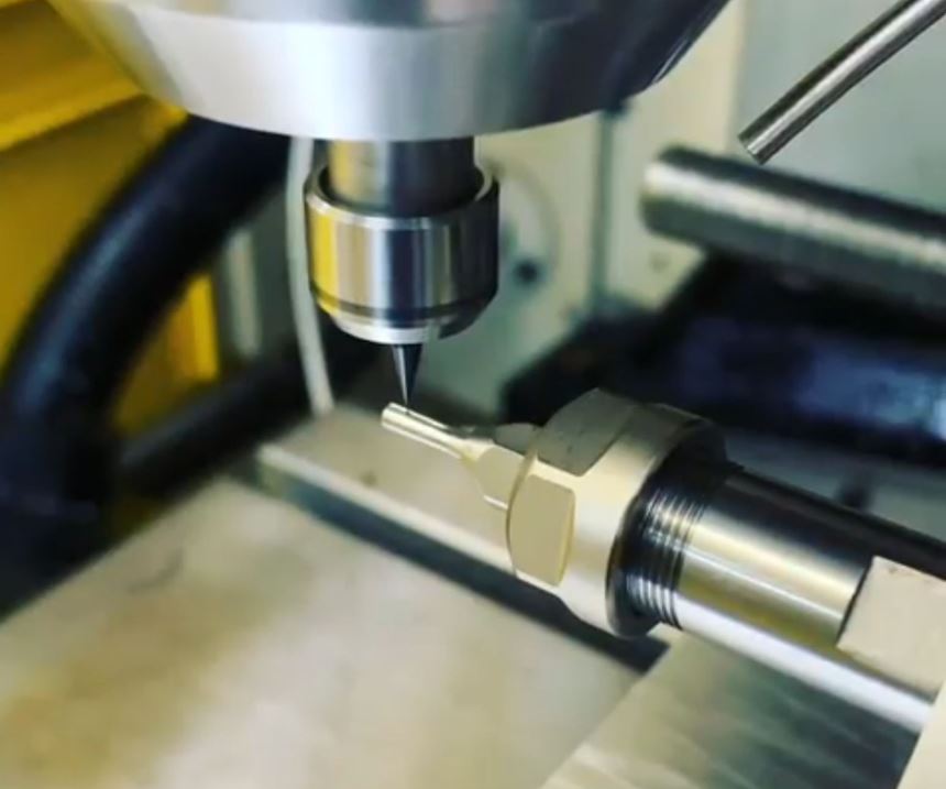

“.019 diameter at +|- .0002? As you wish.” Credit: Instagram User @micro_precision_machining
