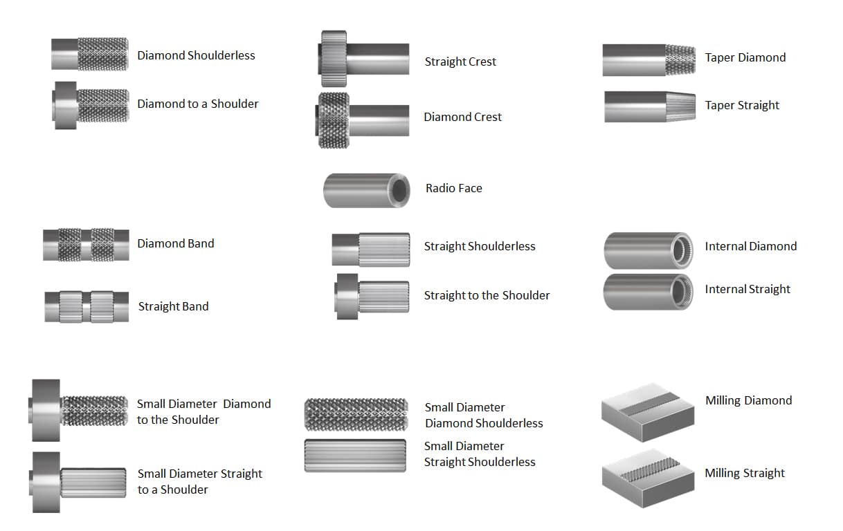

Knurling patterns
Knurling can produce different types of patterns. Some popular knurl patterns are straight, diagonal, and diamond. Check out this diagram that showcases the variety of knurling tools for different applications.
Image Credit: www.doriantool.com
