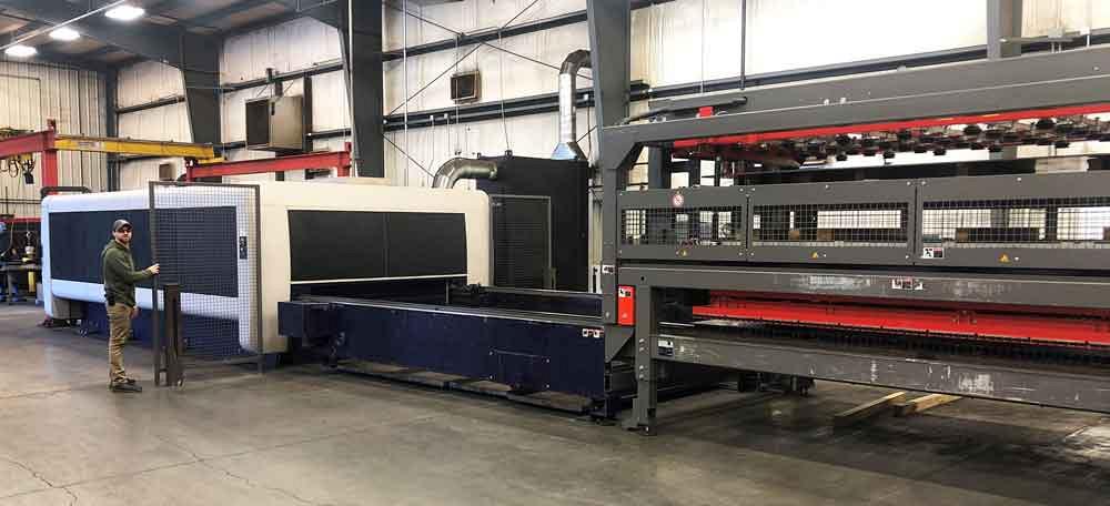

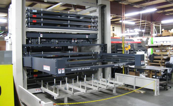

New technology in the fabrication industry has given the metal fabricator more options to produce parts for their customers. Fiber laser cutting machines, in particular, allow the fabricator to cut more parts in a day than it ever could with CO2 lasers. Automated load and unload systems attached to these laser cutting machines also allow the shop to cut almost 24/7.
While fabricators can cut parts more quickly than ever before, they have to deal with other bottlenecks downstream from the laser. Depending on the cut quality or customer requirement, they might need to deburr, edge-round, or remove the oxide layer on a part. To stay competitive and get parts out of the shop in a timely fashion, fabricators should look at automating the deburring process just as they did with the laser cutting process.

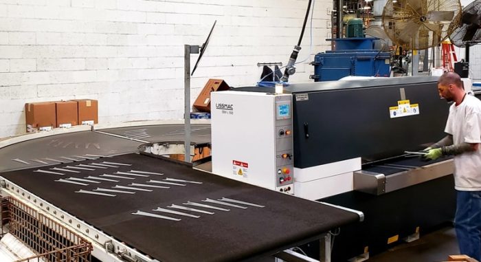

Automated deburring and edge rounding equipment can help a fabricator reduce employees’ fatigue levels by making the deburring job easier than manual deburring. With automated deburring machines, employees are asked to move laser-cut parts from the skeleton to the conveyor feeding the deburring equipment. Bar code scanners have also made setting up the machine easier. Once the bar code on the part is scanned, the machine can adjust to the material thickness designated by code. It also can turn on or off each working head. The operator doesn’t have to worry about the manual adjustment of tools or sand blocks. Machines with wear compensation give consistent edge rounding as they measure wear.
The use of motorized straight-line or return conveyors allows for more efficiency and reduces the operator’s movement and lifting. The footprint of an automated deburring machine or the machine and accompanying conveyors is relatively small, especially when compared to the layout of a laser cutting machine. This type of cell setup keeps older workers productive and on the job longer, when their presence has never been more valued.
