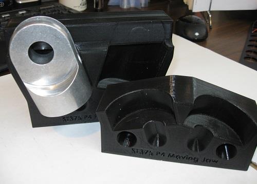

1. Related features at different angles
Photo 1 shows the in-house fixture mentioned above. The part has machined features that locate with respect to features at other angles. The fixture, for use with a rotary indexer, clamps the part in a way that preserves access to various machined surfaces within a single cycle. Mr. Szpak extended the efficiency of the fixture by designing it to hold several pieces at once.

PHOTO 1: The part on this fixture (one part is clamped) has machined features precisely relating to one another at different angles.<br /><br />
