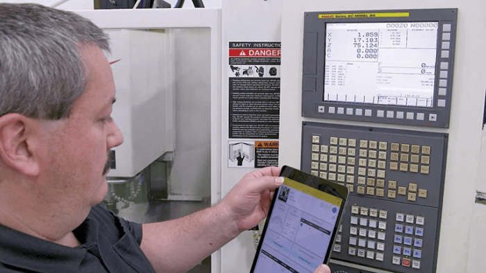

FANUC offers two data analytics programs, MT-LINKi and FASData (shown here), both able to capture vast amounts of machine tool data.

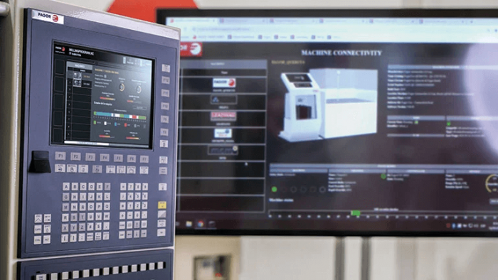

Fagor’s ARFS (Adaptive Real-time Feed and Speed) control offers adaptive control capabilities that continuously monitor spindle and axis loads, machine vibration, and other values.

Fagor Automation Corp., Elk Grove Village, Illinois, is another control provider with its eye on the Industry 4.0 prize. Harsh Bibra, general manager for North America at Fagor, explained that its ARFS (Adaptive Real-time Feed and Speed) control does all this and more, but noted that this type of sensor-based technology can also be used for predictive maintenance.
“We also offer our i4.0 Connectivity Pack,” he said. “This allows users to collect machining data, of course, but also do things like send condition-based alerts, tune the machine tool and update its firmware, change parameter settings, and so on, all from a mobile device or remote computer.”
