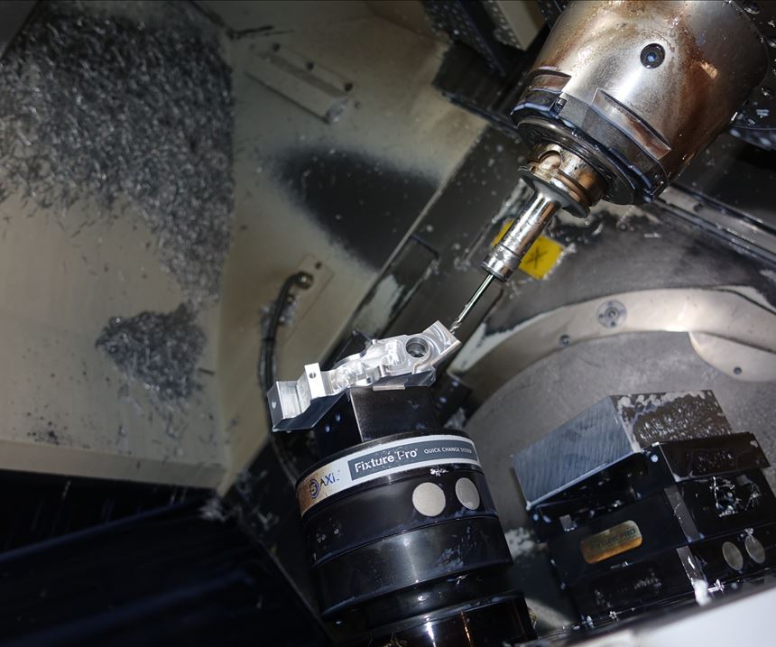

A part Mr. Dunaway cites to illustrate how far the shop has come is one he calls the “elbow,” a component formerly requiring seven operations on three VMCs. The complex part has features at various angles, some of which have to locate accurately with reference to datums on three different faces. He knew the part personally because its setups were so finicky that it was difficult for him to trust anyone else to run it.
Now, plenty of employees run it. Two setups on an HMC accomplish all of the machining. Features referenced to three datums of the part always locate correctly, because those features are now machined in the same cycle as all of the relevant datums. Thanks to the efficiencies of consolidating machining into fewer cycles, plus the gains the shop has realized through high-speed machining, the total machining time for this part has been reduced from 14 hours to 6 hours, and that doesn’t even include saved setup time. On a more expensive machine, the shop has realized a less expensive process.

5. Fixturing. Workholding for Advance used to mean just vises. On the HMCs, workholding often entails a column fixture mounted in the machine using the Ball Lock system from Jergens, a system that assures rapid clamping and precise setup location. This system pays for itself when customer demands suddenly change, because the Ball Lock tooling enables jobs to be rapidly swapped in and out of a machine.

The part in his hand exemplifies why an HMC’s approach to machining has been valuable. A tapped hole at an odd angle used to require a setup of its own when this shop ran the part on verticals.
