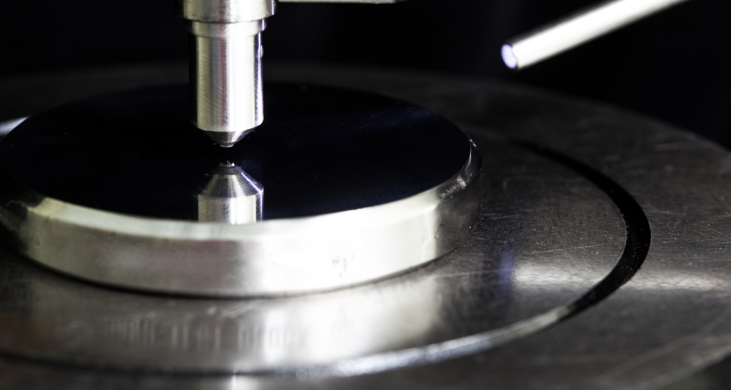

There are various methods and units to measure hardness. The most commonly used units in the machining industry include Rockwell, Brinell, and Vickers. In this text, we will explore these units, identify their differences in usage and measurement, and learn how to convert between them.

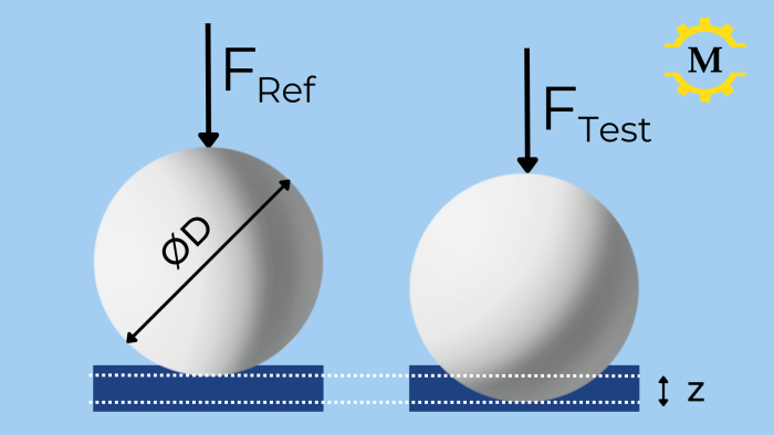

Rockwell (HRC/HRB/HRA)
Rockwell is the most common unit used on drawing callouts. The test is done by measuring a sphere’s penetration depth under a large load compared to the penetration made by a reference preload. The Rockwell scale is divided into 9 sub-scales marked by letters A-K. Each scale uses a different reference load and different sphere sizes. In machining, the most common is the C scale (HRC). Machined metal is usually between 10-65 HRC.

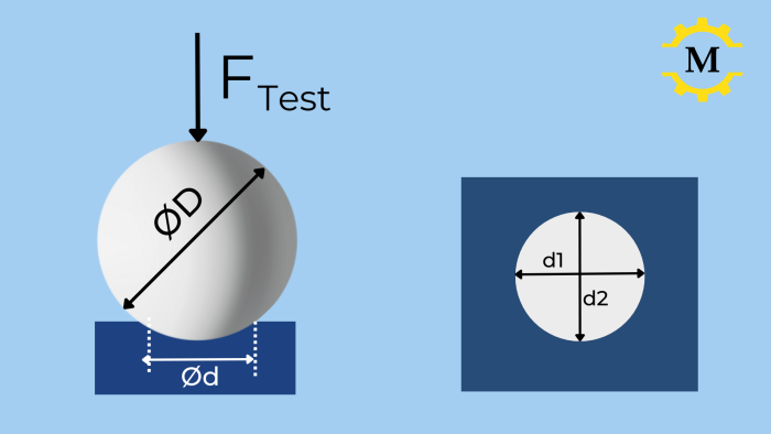

Brinell [HB]
Brinell is the most common unit used for listing the hardness of machined materials (For example, in cutting condition charts that the cutting tool suppliers provide). The test is done with a 10 mm steel ball pressed with 3000 Kgf (6,614 Lbf). Typical values for machined materials range from 100 HB for very soft materials to 650 HB for heat-treated steels.
The Rockwell C scale only covers hardness above 180 HB, requiring a switch to Rockwell B for lower values. In contrast, the Brinell scale covers the entire range.

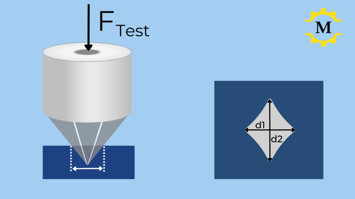

Vickers [HV]
Vickers is a go-to unit for listing cutting materials such as Carbide grades, Ceramics, CBN, and PCD. The HV number is determined by dividing the force by the surface area of the indentation left by a diamond in the shape of a square-based pyramid. Carbide grades are usually in the range of 1,300-1,900 HV. Ceramics can reach a hardness of 2,000 HV, CBN up to 3,000 HV, and PCD up to 6,000 HV.

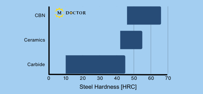

It may seem counter-intuitive, but very soft materials are not ideal for machining. This is because controlling the swarf below a certain hardness can be challenging, and the raw material tends to stick to the cutting edge, causing BUE (Built-Up Edge). When the hardness of the material surpasses a certain point, increasing the hardness any further will result in increased wear, requiring you to reduce the cutting speed or accept a lower tool life (The sweet spot is around 200 HB/15 HRC). Once you exceed a certain threshold, using a conventional carbide insert to machine the material will become impossible. Advanced materials such as Ceramics and CBN (Cubic Boron Nitride) will be necessary.
