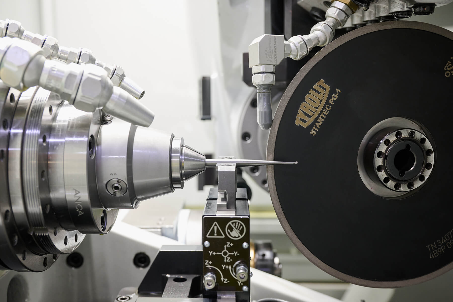

With peel grinding ANCA’s capability combines blank prep and 5-axis grinding in one platform

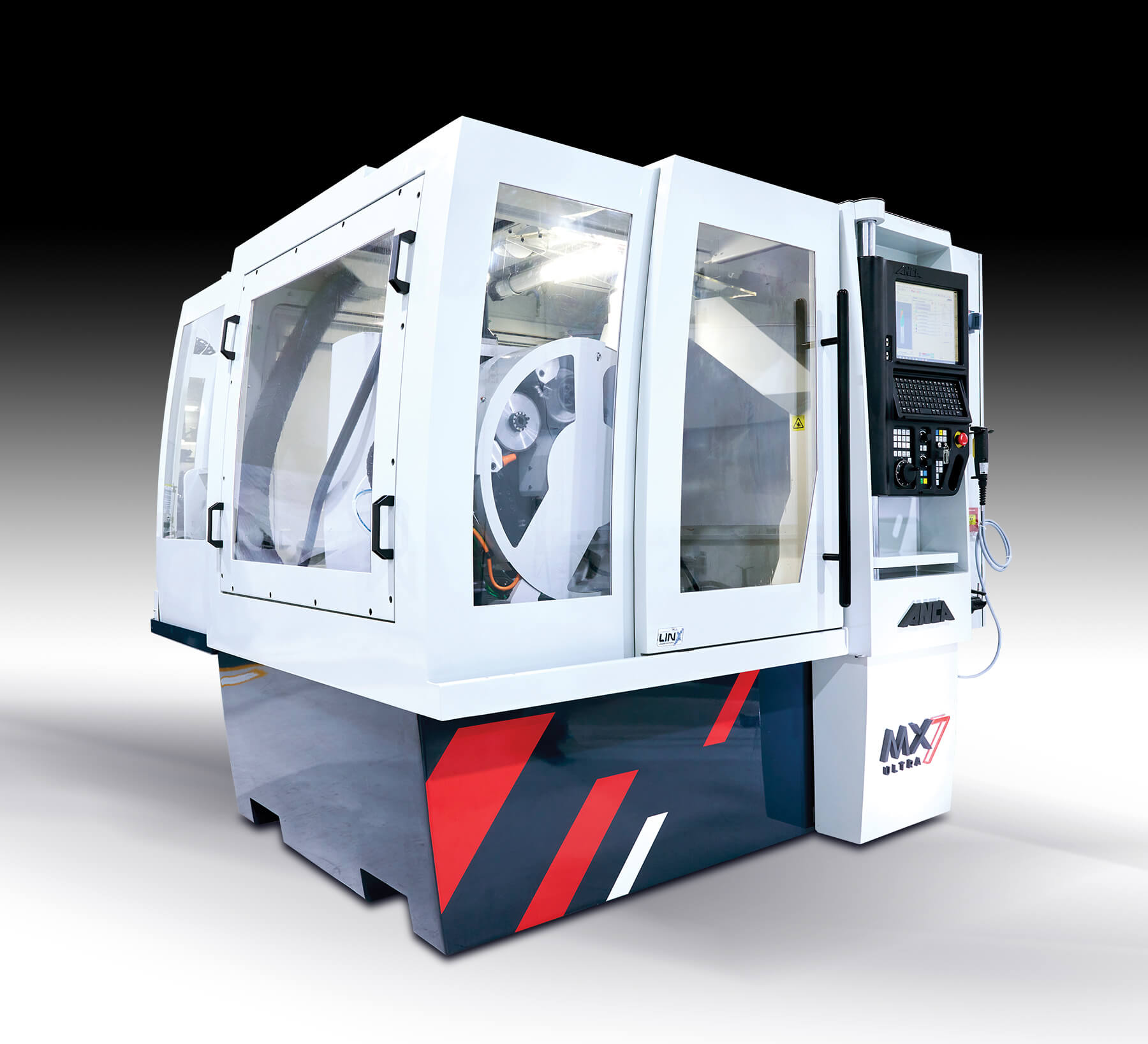

ANCA is committed to producing machines that deliver market leading tool quality such as with the MX7 ULTRA

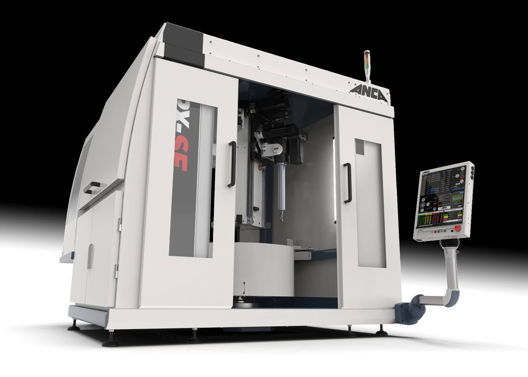

Building a complete set of tool production solutions at ANCA with the EPX-SF stream finishing machine
