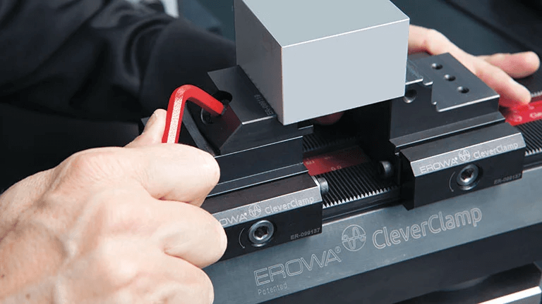

In EROWA’s case, this might be the MTS (Modular Tooling System), although Holzmacher is quick to point out that the company offers several similar workholding solutions, among them the EROWA UPC (Universal Power Chuck), CleverClamp, and PowerChuck P systems. “The MTS is the newest of these and is typically for larger production work on five-axis machining centers. The UPC is also quite popular, depending on the required level of accuracy,” he said.
In addition to universal baseplates, zero-point systems like these are growing more common. As with EROWA, most workholding companies now offer some form of pull-down, retention knob-like clamping hardware and accessories. One of these is SCHUNK Inc. in Morrisville, N.C., where Brad Evans, stationary workholding team lead, noted that the newest of these—the WDM-5X—is a manually-activated system that combines the toolmaker’s VERO-S technology with a series of stackable modules, providing more than 1,000 clamping possibilities.
EROWA’s modular CleverClamp system is said to be a universal workpiece clamping system designed for one-offs and low-quantity work.

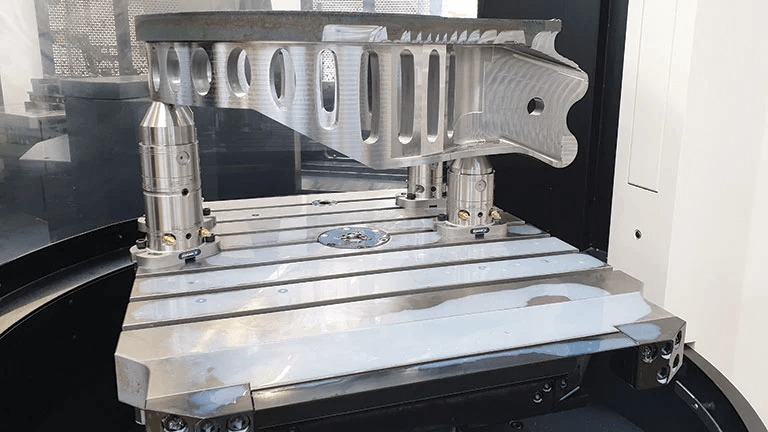

“The WDP-5X is a pneumatic version of the same system,” he said. Both are modular, but are designed for quick-change clamping as opposed to palletizing. “A mold and die shop, for example, might stack up various components to support and position a mold base, then use a pair of VERO-S modules with the clamping pins attached directly to the workpiece to secure it in place. Or the whole thing could be set up offline on a grid plate and dropped onto those same VERO-S modules,” said Evans. “Either way, it’s far faster and more accurate than straps and toe clamps and everything is easily reconfigured to whatever comes in the door next, significantly reducing the need for custom fixturing.”
Evans pointed to several other components of the WDM-5X system, among them a line of telescoping, five-axis stabilizers designed to reduce vibration when machining tall workpieces. SCHUNK also offers the KSP-BWM series of pneumatic vises with quick-change jaws, all of which work with the VERO-S platform.

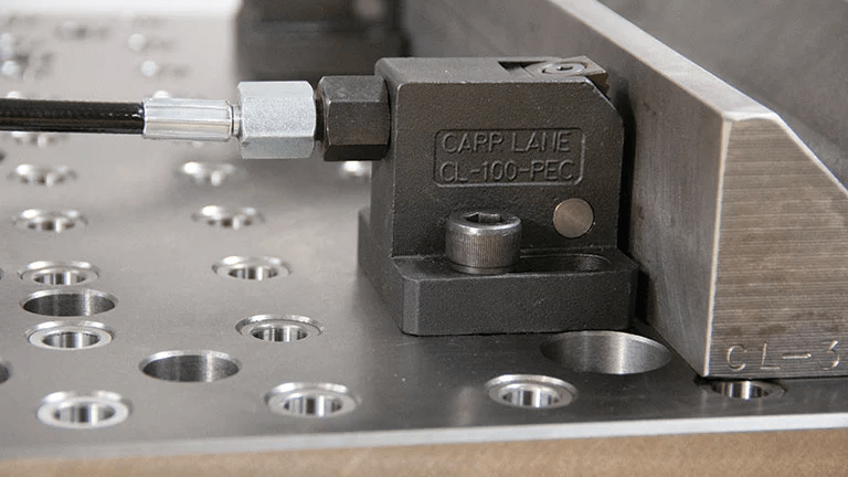

Carr Lane Manufacturing Co., St. Louis, Mo., sees similar trends. Chief Operating Officer Colin Frost agreed that modular workholding of all kinds is growing in popularity, but particularly that designed for five-axis machines. “Workholding for these applications must provide as much access to the workpiece as possible, which requires different strategies than traditional workholding,” he said. “For example, we recently developed a line of low-profile edge clamps that are equipped with slotted bases for easy adjustment during mounting.” These devices are also convertible from mechanical to hydraulic, allowing for basic automation.
The WDM-5X and WDP-5X systems combine SCHUNK’s VERO-S technology with a series of stackable modules, providing more than 1,000 clamping possibilities.
Also new at Carr Lane are mechanical zero-point systems that attach directly to the workpiece. Frost explained that the DropZero system provides for clamping and locating in a single device, and are designed for use with the company’s modular sub-plates and blocks. “They can also be mounted to one another to support uniquely shaped workpieces,” he said.

Carr Lane Manufacturing has recently developed a line of edge clamps that allow for greater access in modular applications, with slotted bases for easy adjustment during mounting.

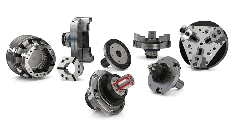

Larson said the company recently expanded these capabilities with the Hainbuch modular system, which includes TOPlus and SPANNTOP chucks and mini chucks, the TOROK manual chuck, and the HYDROK hydraulic stationary chuck. Each is available with various “adaptations” such as OD clamping heads (collets), ID mandrels, two-jaw and three-jaw modules, face drivers, and magnetic chucks.
“There are ten different workholding devices in our modular system, giving users around 65 different combinations,” he added. “The system also works on a milling machine, so again, there’s a great deal of flexibility. And for shops using one of our collet chucks, changeover within 10 seconds or so is possible. And with a properly-equipped robot, it’s possible to automate much of this changeover.”
