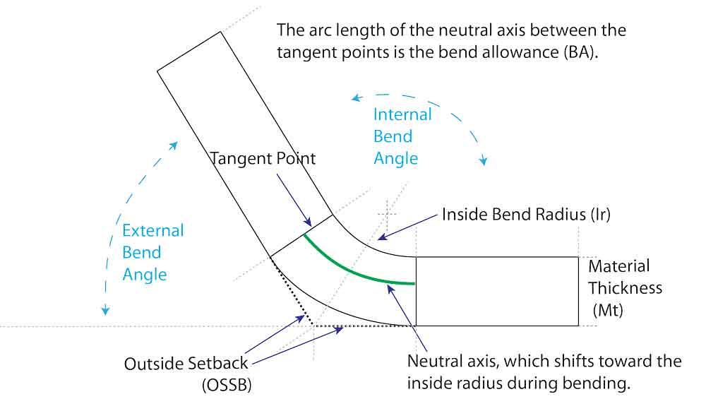

Figure 1 To perform basic bend calculations, we use the bend angle (A), inside bend radius (Ir), and outside setback (OSSB).

Question: I’m an instructor at a sheet metal training facility and need to clear up 90-degree bend calculations for bottoming. We have been teaching two methods, and I would like to know which is correct. We use mild steel in both situations.
Under one method, bend allowances are determined by adding 20% of the material thickness per half-bend for the ID or subtracting 80% per half-bend for the OD.
The other method is based on material thicknesses. For an ID bend allowance, add half a material thickness for an OD calculation and subtract half a material thickness from the ID legs. (Editor’s note: In this instance, ID and OD stand for inside and outside dimensions of the finished part.)
Answer: Both are correct to a point; however, there are other ways. It all depends on the accuracy your parts require.
If your parts are always made from the same type and thickness of sheet or plate material and using the same punch and die set, you could bend a piece and measure the change and run with that number. And you could use either of the two formulas that you suggested if you have a significant enough tolerance, something like a tolerance of 0.032 in., for example.
You could also use one of many other formulas that are very accurate. I use them to calculate the outside setback (OSSB), bend allowance (BA), and bend deduction (BD). Without a long-winded explanation, they are:

BA = [(0.017453 × Ir) + (0.0078 × Mt)] × A
OSSB = tan (A/2) × (Ir + Mt)
BD = (OSSB × 2) – BA
Figure 1 shows you where these measurements appear on a bend. You can find many more details about the bend functions in the Bending Basics archive here. For more details on these bend functions, you can refer to the Grand unified theory of bending that ran from September through December 2015. You can also check out The basics of applying bend functions, which walks you through the basics of flat-blank calculations using these formulas.
Also, if you’re curious, the BA formula I use does incorporate a k-factor, it’s just hidden. The “0.0078” figure in the formula is pi divided by 180 multiplied by 0.446, an average k-factor that works for many applications. The k-factor is a ratio that describes the neutral axis’s shift during bending. For more on this, check out K-factors, Y-factors, and press brake bending precision.
