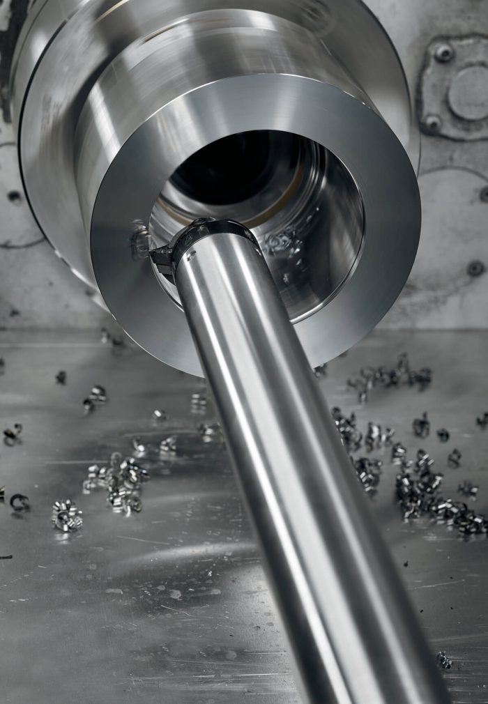

In this case Sanchez felt the right solution was the Walter Accure·tec A3000 boring bar. Why? “Conventional steel or solid carbide boring bars are often ineffective at length/diameter ratios beyond 6 x Dc,” says Sanchez. The new Accure∙tec A3000, on the other hand, with its vibration dampening system, excels at length/diameter ratios beyond 6 x Dc. That’s the point, claims Sanchez, where conventional steel or solid carbide boring bars often prove less capable.
The new Accure∙tec A3000, with its vibration dampening system, excels at length/diameter ratios beyond 6 x Dc
Because shops are often worried — and justifiably so — about time-consuming “fine tuning” of the dampening function, Walter’s anti-vibration
feature is preset at the factory, so the tool is ready for quick application. In addition, the new boring bars feature compact QuadFit precision quick-change exchangeable heads, designed to boost versatility and decrease downtime. Internal coolant delivery for optimum chip removal is another Accure∙tec A3000 feature that aims to speed production while improving surface finishes, the latter being  crucially important in many oil and gas flow parts.

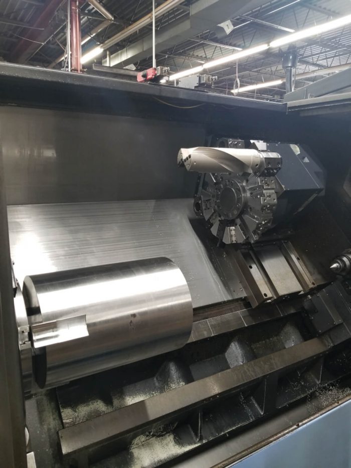

The Walter tools CMG planned to employ in this application included a Walter 3¾ in. indexable insert drill. The indexable carbide inserts featured Tiger·tec® Silver coating technology designed to boost performance through its optimized microstructure and reduce residual and thermal stress wear.
Walter indexable insert drill. The indexable carbide inserts featured Tiger·tec® Silver coating technology designed to boost performance through its optimized microstructure and reduce residual and thermal stress wear

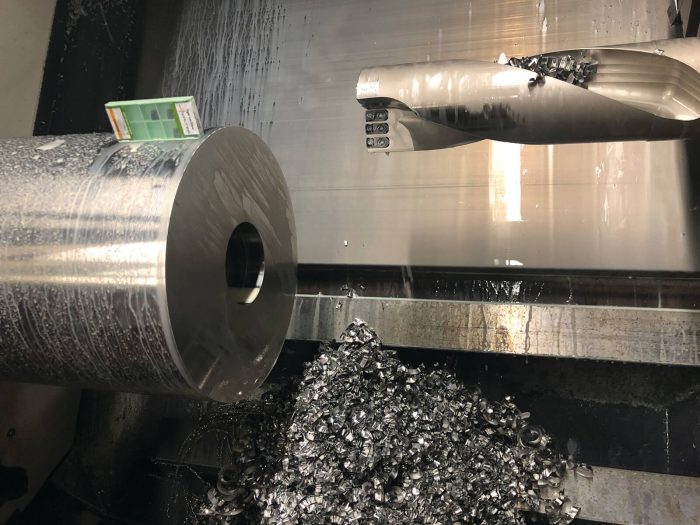

First the main chamber, measuring 3 ¾ in. wide and 11 in. deep, was roughed out using this indexable drill, after which hardness had risen from 30 Rc when drilling to 40 Rc.
“We were then ready for the boring operations using the new Walter boring bar,” notes Crim. “We were ready to run this on our Doosan Puma 300L CNC turning center and put the proposed new application which we had worked out with Dan, to the test.”
Lights…camera…action, like they say in the movie business, but this scene, like many, wasn’t about to be wrapped up in one take. Sanchez notes, “This was a prime example of not using a conventional or cookie-cutter approach. In this case, we had to adjust running parameters (speeds & feeds) to fit the machine capabilities. The machine didn’t have enough horsepower to run at “recommended” speeds & feeds and that’s why we had to dial it back, through trial and error.
“Our first try wasn’t the success we had hoped for, so we dialed the parameters back a little bit to make it work,” Sanchez notes. In the first test, as he relates, the machine was run at 335 sfm at 0.0038 in. feed per revolution. It resulted in a spindle overload alarm (130%).
For the second test, speed was 458 sfm at 0.0038 in. feed per revolution. The same spindle overload resulted.
In the third test the sfm was kept the same but feed per revolution was dialed back to 0.003 in. The result was “no overload alarm but was at about 90% – 95% spindle load.”
For the fourth test, 458 sfm were run at 0.0015 in. feed per revolution. “Success!” Sanchez exclaims. It was a process and results everyone was happy with. The four iterations, he recalls, took less than a day.
