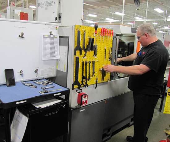

The principles of lean manufacturing help machine operators such as Dan Szczepanski, who runs one of Micron’s Citizen CNC Swiss-type lathes, focus his experience and talents on what is important — making parts to spec and looking for ways to improve the process.

Today, a walking tour of Micron’s shop areas reveals all of the classic hallmarks of a company well along the lean journey. These include shadowboards for hand tools; posted checklists for setup procedures, machine maintenance and housekeeping items; standardized work guidelines; and several kanban stations.
