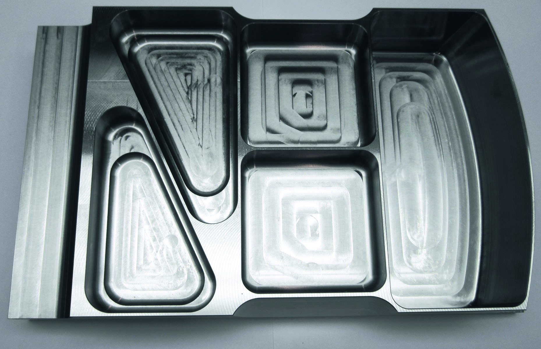

In the aerospace industry, titanium cutting is usually done from solid forgings and consists of pockets with thin walls and bottom faces, which can pose a challenge.
Using a generic component made from Ti6Al4V, the Walter demonstrated typical processes for structural components.

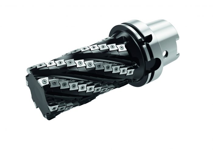

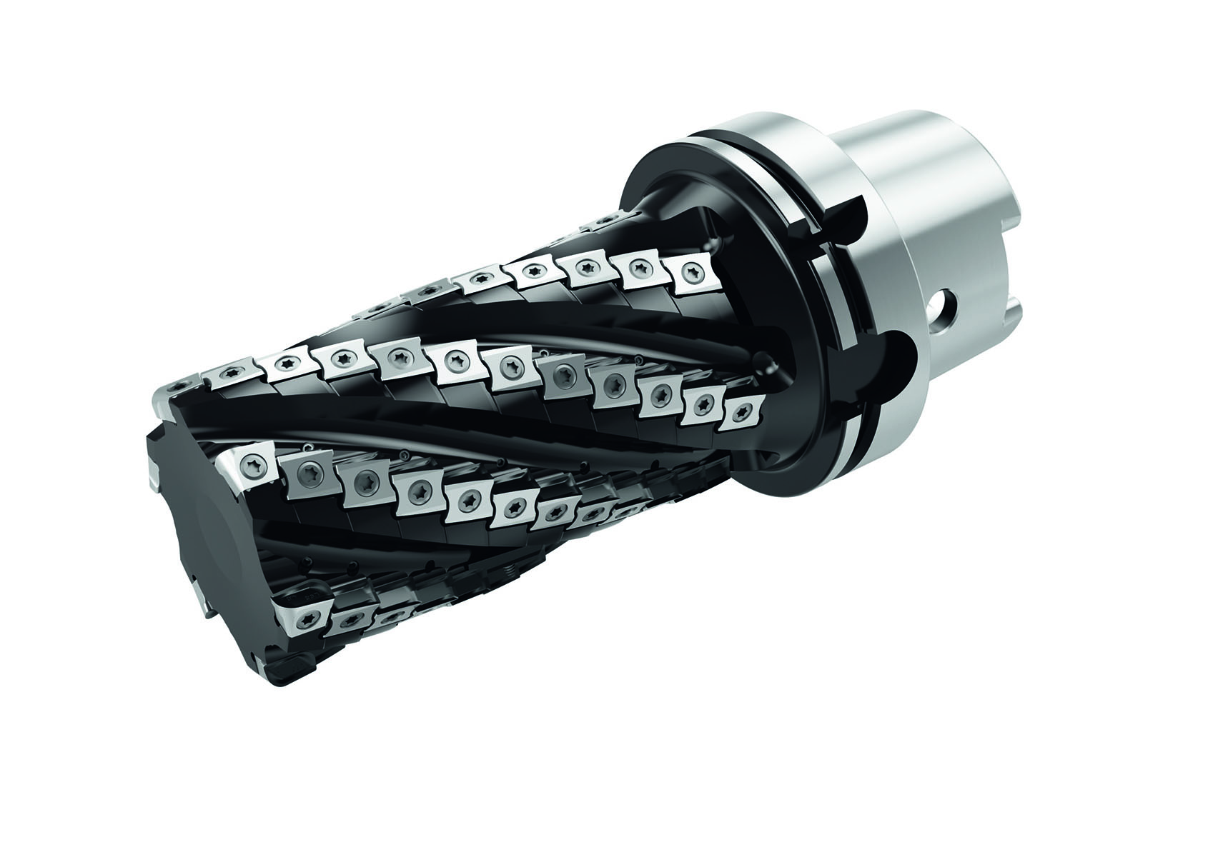

The Walter M3255 helical milling cutter for roughing pockets or shoulders.

A good suite of tools from Walter for cutting commercially available titanium (Ti6Al4V, Ti 5-5-5-3, etc.), includes the M3255 tangential porcupine milling cutter, the M4002 high-feed face milling cutter (roughing operations), the Ti40 solid carbide end milling cutter, and the modular ConeFit variant with Ti50 changeable head (semi-finishing and finishing operations). Indexable inserts and solid carbide milling cutters help to maintain the balance in applications like this.

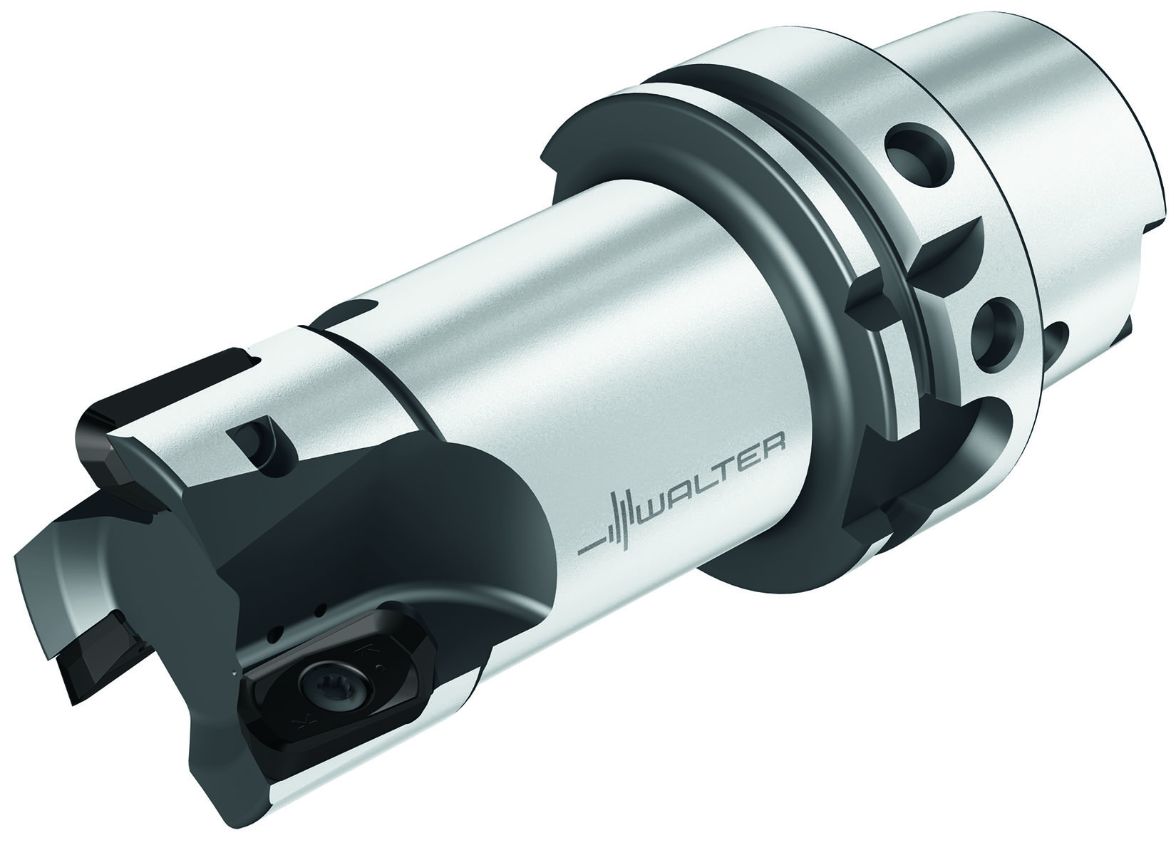

The new M2131 ramping milling cutter from Walter specializes in HSC machining of aluminium materials.
The coatings, as well as the macro geometry and micro geometry of the two solid carbide tools are designed specifically for titanium machining, which makes them perfect for aerospace applications. The M3255 and M4002 milling cutters have indexable inserts made from the new Walter WSM45X cutting tool material. The extremely tough CVD coating is ideally suited to high temperature alloys and stainless steel (ISO S and ISO M) applications, which includes titanium.
