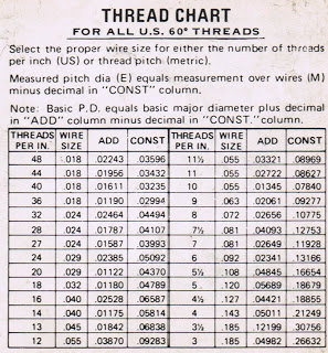

Wire sets come with charts that look like this:
thread chart
Image credit: machineshoptalk
These charts are used to determine the diameter of the wires you’ll need to use to measure the thread and the constant that you’ll need to subtract from the initial measurement to calculate the pitch diameter. To measure the thread using this method you’ll need 3 wires and a micrometer. Here are the steps to follow:
1. Place and hold two wires in two adjacent pitches on the top of the part
2. Place and hold the third wire in the pitch located across the part from where the two top wires are positioned
3. Use the micrometer to measure the distance between the top wires and the bottom wire
4. Subtract the constant that refers to the wires from the measurement to obtain the pitch diameter size.

    You have to be very careful with the thead wires!!! I have found inexpensive thead wires to variate in the diameter and roundness. If the wires have two or three thousands variation imagine how much it would affect the measurment. The best thread wires are van kurens, hardened and ground to one or two tenths on the diameter and roundness
