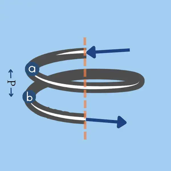

The Basic Thread Milling Toolpath
A spiral movement is required to perform a thread milling operation. Helical interpolation is a CNC toolpath along a helical path. This spiral motion combines circular movement (G02 or G03) in the XY plane with a simultaneous linear motion in the Z direction.
The Z distance from point A to B equals the pitch.
The diameter machined by the tip of the cutting tool is the thread’s major diameter in internal threads or the thread’s minor diameter in external threads.

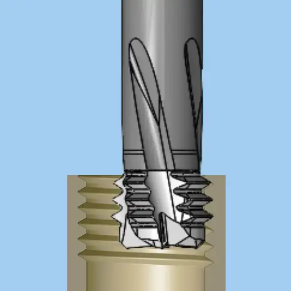

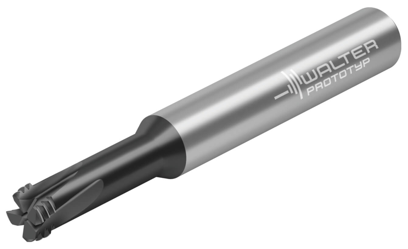

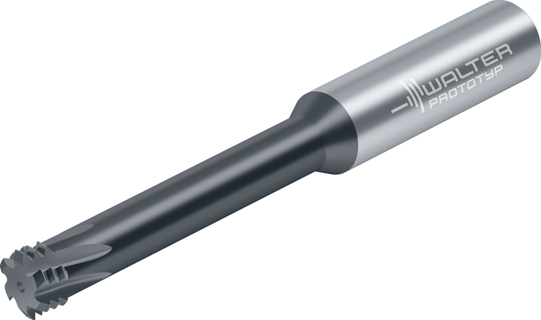

  • Single Tooth: In this scenario, the tool makes a continuous toolpath, completing numerous full rotations according to the thread’s length divided by the pitch. The advantages are that less load is exerted on the tool, and that the tool is cheaper. The disadvantage is that this configuration yields the longest cycle time.

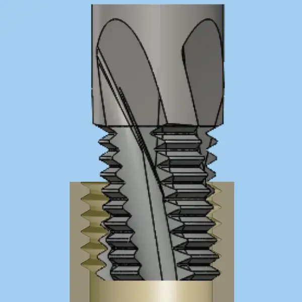

  • Multi Tooth (Cutter length Longer than thread): This scenario has two major advantages and is the first choice except when the load can be sustained. The cycle time is the shortest, and the CNC program is the simplest. This is because the tool only needs to make a single 360° movement to complete the operation. However, it should be noted that the tool comes with a higher price tag and experiences greater loads.

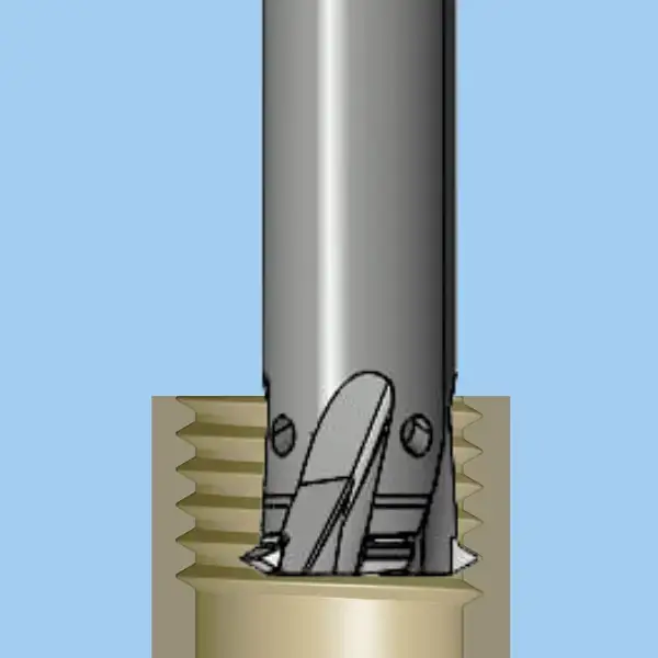

  • Multi Tooth (Cutter length Shorter than thread): When the thread is very long, or the load is too high, it is necessary to use this configuration. However, it comes with two main disadvantages. The CNC program is more complicated, and there might be a slight mismatch between iterations as the operation is not continuous.

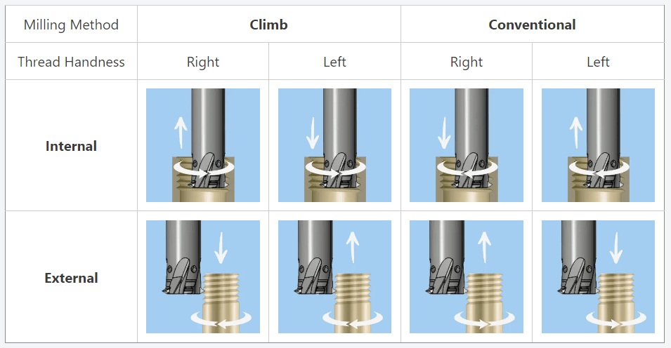

CNC Program Directions
To determine the required directions, there are three factors to consider: handness (right or left), thread type (external or internal), and milling method (climb or conventional). Use the table below to figure out the required directions for your configuration.

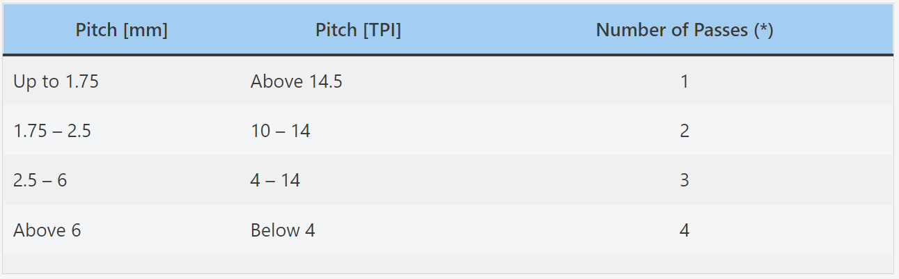

Radial Passes
When the thread profile becomes deeper, it is advisable to divide the operation into several radial passes to lessen the burden on the cutter. By increasing the number of passes, you can enhance the tool life, surface quality, and production stability. However, this will also result in a slower cycle time.
Use the table below as a starting point for the number of radial passes and adjust according to your specific application.
