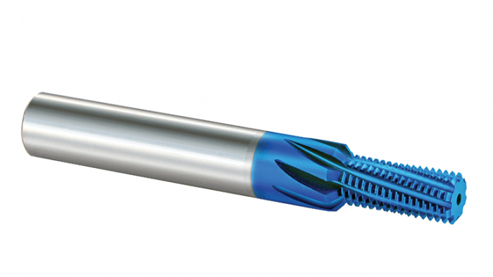

The FMT thread mill features Carmex’s proprietary nanocoating for longer tool life and more flutes for faster cycle times.

From small diameters down to 0-80 UN to high-hardness mills that can handle materials up to 62 HRC, Carmex has created three-tooth mini mills (its MTS and MTSH lines). Other recent additions include:
  • FMT, which features Carmex’s proprietary nanocoating for longer tool life and more flutes for faster cycle times;
  • AMT, an uncoated, polished thread mill for aluminum and plastic; and

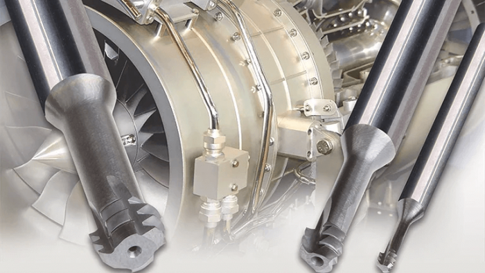

  • J Thread external thread mill, used primarily in aerospace applications.

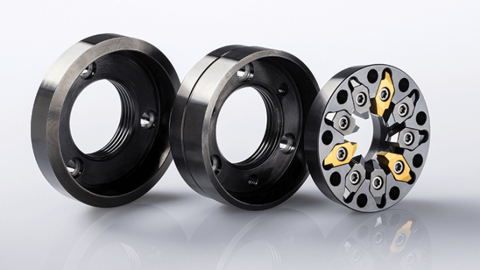

Horn’s Turbowhirling configuration uses roughing and finishing inserts to generate thread profiles.
Horn offers several options for whirling. The company’s most popular whirling ring is the standard Horn design. “This system accepts our S302 inserts, which are a triangular design having three indexable edges,” Kollenbroich said. “These inserts are precision ground for extreme accuracy and excellent repeatability.” Horn’s standard whirling rings fit whirling units from many machine manufacturers, he added, including Star, Citizen, Tsugami, Tornos and many others.
Horn also offers its Turbo Whirling design, “which uses our S271 insert—a double-side insert with two indexable edges. This offers customers the option of six- or nine-pocket cutter rings and uses a unique design that allows for roughing and finishing in one pass. This allows for much faster feed rates and increased tool life. Feed rates can easily be twice what is run with our standard design.”

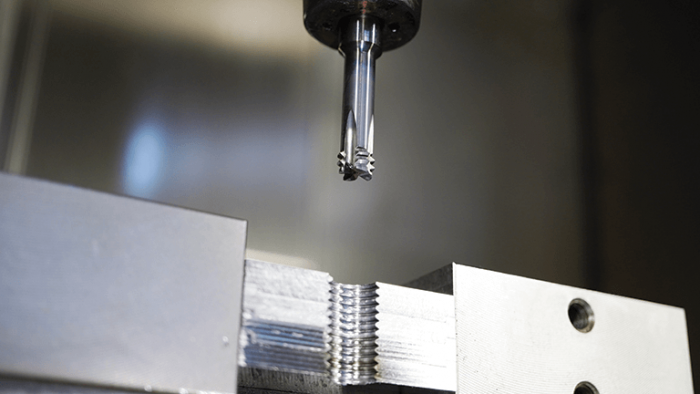

The ZGF-S-Cut by Emuge is tailored for hard metals and exotic materials common in aerospace and medical applications and is designed to resist cuts or fractures. The single plane cutting tool features three rows of cutting teeth.
These tools “are designed to be run with a left-hand spindle rotation,” he added. “A climb milling routine effect will result when combining this rotation with the 10° left-hand flute helix angle on the cutter programmed in a counter-clockwise rotation but entering from the top of the hole in a conventional clockwise milling routine path.” Dedicated to producing one-size thread pitch, these tools feature a multilayer TiAlN-T46 proprietary coating, said Blandon, “providing great cutting-edge protection for increased tool life in abrasive and edge-wearing materials.”
