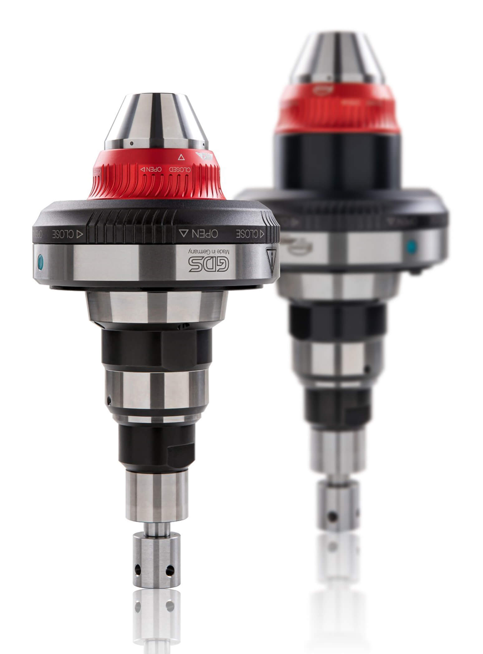

ANCA has partnered with GDS, a renowned German manufacturer of high-quality precision accessories for grinding and machining processes. One of their flagship products is the µGrind workholding, which is now available from ANCA’s distribution network. The µGrind has been customized to suit the requirements of ANCA grinding machines and can be set up in a matter of minutes.
GDS ANCA uGrind fitted to the ANCA FX Linear machine

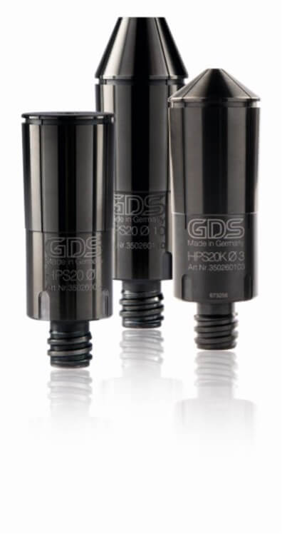

  • Flexible – a suite of compatible collets with form factors to suit almost all applications is available. µGrind comes in two form factors (standard and long nose) to suit almost all applications.
Flexibility – GDS µGrind comes in two form factors

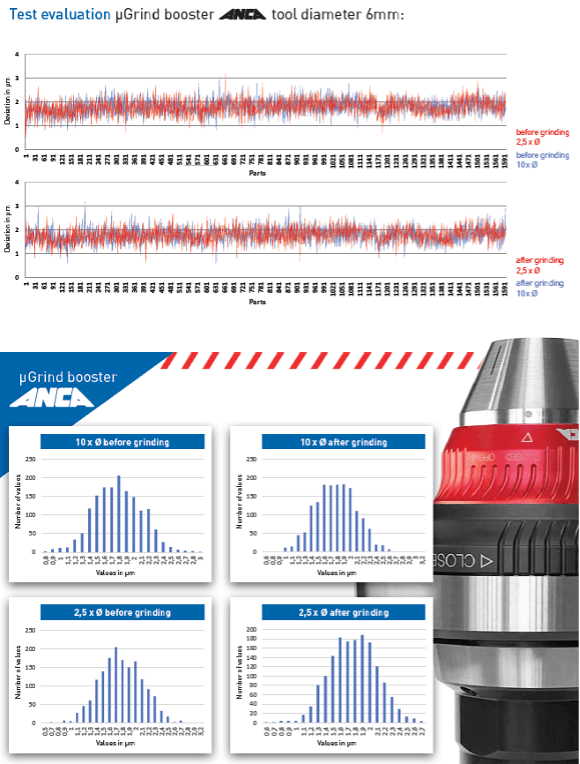

µGrind performance has been tested in real-life applications and the results are very consistent. A test was performed over a large batch of 6mm tools where runout was measured before and after grinding at 2.5 x Ø and 10 x Ø. Even with thousands of clamping and diameter changes, the runout remained virtually unchanged.
