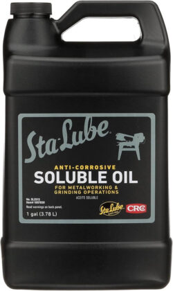

Sta-Lube SL2513 Soluble Oil
Sta-Lube Soluble Oil SL2513-1 Gallon, Anti-Corrosive
Order Now
Sta-Lube is great for multiple machine shop applications, particularly grinding. This soluble oil is non-corrosive and used for improved wetting, cleaning and lubricating during metal cutting and grinding applications.

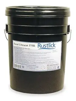

Rustlick 74905 Ultracut
74905 Ultracut 375R 5 gal
Order Now
This is a heavy-duty, biostable, semisynthetic fluid with chlorinated EP additives. It allows for a long sump life and can be used in a wide range of operations, from milling to drilling.

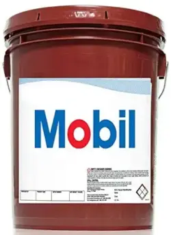

Mobil Mobilcut 100 Aqueous Metalworking Fluids
Mobil Mobilcut 100 Aqueous Metal Working Fluids
Order Now
This is a conventional milky soluble oil that readily mixes with different waters to form stable emulsions. Its versatile performance makes it suitable for a wide range of metal cutting and grinding operations for both ferrous and non-ferrous materials. It offers excellent emulsion stability and long-term corrosion protection for both components and machine tools.

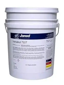

JEI Full Synthetic Multi-Purpose Coolant – VERSAKUT 7227
Full Synthetic Multi-purpose Coolant
Order Now
Versakut 7227 is a multi-purposeful synthetic coolant for grinding, machining, milling, and other CNC applications. Made with a biostatic lube package that will not break down or be subject to selective depletion, Versakut 7227 is the economical solution for a long CNC sump life.

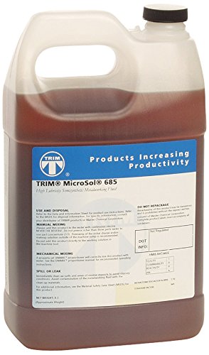

TRIM Cutting & Grinding Fluids MS685/1 MicroSol 685 High Lubricity Semisynthetic Metalworking Fluid, 1 gal Jug
Order Now
TRIM MicroSol 685 is a high-lubricity, semisynthetic microemulsion coolant. The formula offers the performance of a heavy-duty soluble oil with the cleanliness of a semisynthetic. It provides excellent cooling and mechanical lubricity, along with the machine friendly characteristics you expect from a premium TRIM coolant.

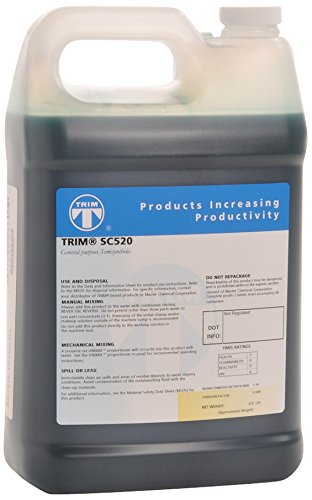

TRIM Cutting & Grinding Fluids SC520/1 General Purpose Semisynthetic Fluid Concentrate, 1 gal Jug
Order Now
A low-odor, low-cost semisynthetic, SC520 is a general-purpose, cutting and grinding fluid concentrate for the multi-material, multi-operational shop. SC520 uses a proven EP-additive package to control built-up edges, improve tool life, and has the wetting and cooling characteristics necessary for superior machining results on high-speed milling and turning operations. It also controls chip welding on soft, gummy materials like aluminum.
