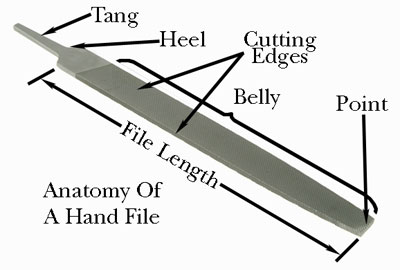

Anatomy
As you can see in the image below, files are made up of several different sections.
hand files
Credit: kmstools.com
The tang is usually softened to allow the handle to be screwed to it. Some files have built-in handles molded over the tang.
The face, or belly, is where the cutting action happens. Some files have more than two faces and feature different tooth patterns.
Similarly, the edges of a file can be smooth or have teeth. Smooth edges are also called safe edgesDepending on its shape or profile, a file can have flat edges, tapered edges or round edges.

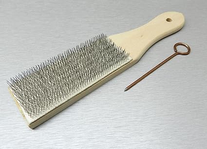

Since files are used to remove material from parts, it’s not unusual to see chips stuck in between the teeth. This phenomenon is called pinning and it’s one of the main causes of uneven surface finish. Luckily, there are a few remedies that can help you reduce pinning, such as brushing a little bit of oil onto the file face or rubbing chalk onto the teeth. The best way to make sure that the face of your file is clear from chips is by using a file card or a file brush (they are often combined).
Crescent Nicholson 10″ File Card and Brush

  • Bluey says:
    The reason why it’s called ‘pinning’ is because the best way to clean a very dirty file having stubborn bits of dirt or metal is to use a sharp pin (I use a scriber) to dig out the muck etc.
  • Tom says:
    An even easier and much faster way to cleean a file, is to use a tool made ftom copper tubing ( I used 6″ length of 3/8″ copper water line). Use a hammer to Flatten one of the tube closed, and “fanned out” slightly. Push thos end across the file, along / parallel with the teeth. Like a scraper, the flattened end will push any “pins” and dirt from between the tetth. After a few scapings, the end of the copper tuibe will fit like a comb in the file’s teeth and do an excellent job. – much better than a file card, and a lot faster than picking at the debris with a scriber. Also, as mentioned, I’ve found rubbing a piece of chalk against the file – filling the grooves with chalk significantly reduces the amount of pinning..
    • Tom says:
      sorry for my spelling errors – it’s been a long day 🙂
    • Mathew Molk says:
      I use a piece of 3/4 copper.. I have one for each of the file “pitches” I have so once they wear in the tooth pattern they fit like a glove right off the bat and being wide it takes less passes. I even got an old vice I made aluminum jaws for that is dedicated to holding files while I clean them. A rub with a chalk ball just like you do finished the job,,,,and do it before you put them away and when you need one, there it is ready to go.
  • SSR says:
    If you are going to pin your file, use a flat brass piece about 3/16″ wide by 1/8″ thick push with the teeth. It’s always to have a file card around your tool box. Here’s a look see. https://images-na.ssl-images-amazon.com/images/I/81Twt1hNU4L._AC_SX425_.jpg
