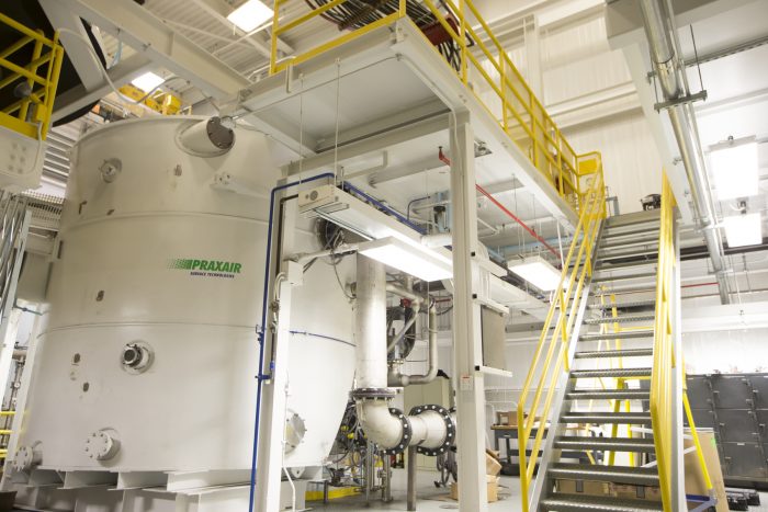

Praxair’s advanced vacuum induction-melt argon-gas atomization processing produces fine, spherical titanium powder for additive manufacturing. Traditionally a supplier of atomized superalloys of nickel and cobalt, the firm’s ability to now produce large-scale volumes of titanium powder promises to help support what has become a rapidly expanding market for 3D metal printing with titanium.
Capacity Online to Meet this High-Growth Market
All of this adds up to a tremendous amount of interest in titanium-powder technology for additive-manufacturing applications. So says Andy Shives, market development manager for Praxair Surface Technologies, a manufacturer of gas-atomized metal powders that recently launched an additive-manufacturing division in Indianapolis, IN, to satisfy what it sees as a high-growth market.
“Gas-atomized powders that traditionally are used for thermal-spray coatings,” says Shives, “are gaining favor for additive manufacturing.” Suppliers of the powders can adjust the composition to optimize them for specific applications. For additive applications, very fine powders can be atomized for use in laser powder-bed machines, and coarser particle sizes for electron-beam powder beds.
Last August, Praxair Surface Technologies announced its launch of newly expanded operations geared toward production of high-purity fine, spherical titanium powder for additive manufacturing. Traditionally a supplier of atomized superalloys of nickel and cobalt, the firm’s ability to now produce large-scale volumes of titanium powder promises to help support what has become a rapidly expanding market.
Unique to Praxair is the adoption of new gas-atomization technology developed recently at Ames Laboratory, a DoE facility operated by Iowa State University. That technology (a specialized nozzle) eventually was licensed to spinoff company Iowa Powder Atomization Technologies (IPAT). IPAT, created by Ames Laboratory researchers Joel Rieken and Andrew Heidloff, was acquired by Praxair Surface Technologies in 2014; Heidloff and Riecken joined Praxair as development specialists.
“We’re the first to employ close-coupled gas atomization for titanium,” Heidloff tells 3D Metal Printing, “which is the optimum process for making powders fine for additive manufacturing. The nozzle that conveys the liquefied titanium through the high-velocity atomization gas is the key to the process, allowing the temperature of the metal to increase to superheating range—100-150 deg. above melting temperature.”
