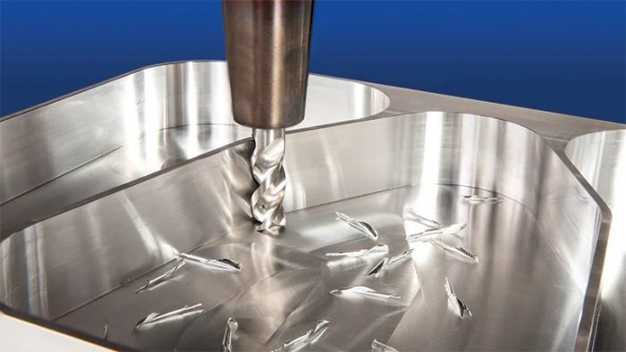

Iscar’s ECAl-H3R three-flute, chatter-free end mill for high MRR in aluminum.
Solid-carbide round tools cover a wide range of applications, including drilling, milling, as well as reaming and threading. The newest product innovations, however, are opening eyes in job shops and production shops to their capabilities in finish machining. New end mill and drill product lines are coming out almost daily that improve machining processes for the more mundane applications in cast iron and steel to the increasingly complex demands of titanium, stainless steel and heat-resistant superalloys (HRSA). Following are suggested approaches by leading suppliers to finding the right tooling match for a variety of applications.

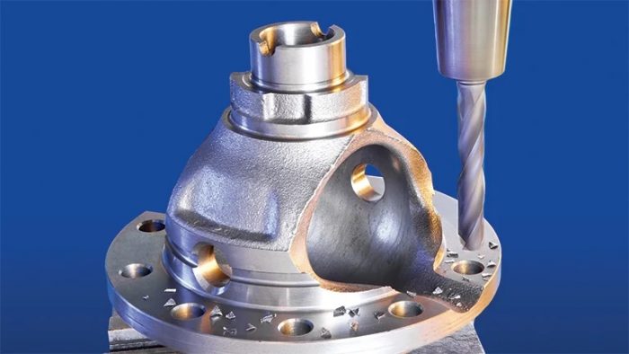

Today’s advanced solid-carbide drills feature modern carbide substrates, coatings, edge preps and updated software for grinding machine capability that allows putting different styles of grinds on the drills, according to Patrick Cline, national holemaking product manager, Iscar USA. “The trend with solid-carbide drills is to machine materials in the hardened rather than in the soft state before heat treating,” he said.
Iscar’s IC903 coated grade solid carbide, with an AH grind special edge prep, drills materials with hardnesses from 55 to 70 Rc. “In the past, you would have to put the holes in the part while in a soft state, which may not be optimal, but your only other option would be to ram EDM the hole which is a slower process,” said Cline.
A micrograin TiAlN-coated SCD solid drill in a precision shrink-fit holder drilling an automotive differential carrier.
Chip evacuation is a major limiting factor in drilling that is being addressed by twisted coolant-through holes, according to Cline. “The twisted coolant holes allow for deep chip gullets with plenty of room to evacuate chips while maintaining a very large and strong core,” he said. “The rigidity of solid carbide allows increasing the length-to-diameter ratios of solid-carbide tools to 20, 30, 40 and even 50 times diameter—ratios unimagined in the past. You wouldn’t see this in the past because if the carbide was tough, it had no wear resistance and if it had wear resistance it was so brittle that it would deflect and break.
“With longer drills the designs are changing,” Cline continued. “For our 20×D, we’ll have four margins down on the bottom. When the first part of the drill is engaged, it has four margins and two of the margins will drop off as you go up the drill body and it’ll be a double-margin drill. Also, you’ll see designs where the gullets have been increased due to the strength of the substrates. The helix ratios will change and the core diameters will change when drilling really deep (20×D). The chips come up the body and we’ll alter the inside diameter of the core to facilitate ejecting them.”
According to Cline, a drill can be produced with a larger gullet area without sacrificing the strength and integrity of the tool. “In the past, if you wanted to make a drill with a large gullet, you would either make it stubby or sacrifice some of the penetration rate since you would run slower to reduce force,” he said. “For faster drilling, we have a line of three-flute solid-carbide drills for a higher penetration rate in order to reduce cycle times.”

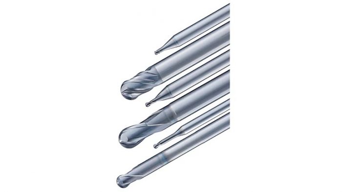

There are three features of OSG’s AE-H ball nose end mills that make them ideal for machining hardened steels and die/mold applications, according to Minhas. “The first feature is the high precision radius tolerance of two-tenths that is very important for surface finish and reduces polishing time. The second feature is its unequal index, which reduces vibration. And the third feature is the variable rake angle, meaning that it’s not the same rake angle from the tip to the main diameter.”
Minhas explained the advantage of having the variable rake angle on the AE-H end mill: “Ball end mills always start cutting at the tip, which is not rotating. The variable rake angle is very strong at the tip to avoid chipping. Then, as you go further up to the diameter of the tool, it’s sharper so that you can cut the material lightly.”
The AE-H ball nose end mill has OSG’s Durorey multi-layer coating on the substrate. Coatings are super heat resistant with an ultrafine nano structure and a special strength medium for long life, fine finish, and process stability, according to Minhas.

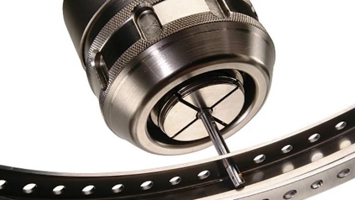

Deburring drilled holes and bores in production quantities represents a challenge to companies in virtually every industry. To deal with these challenges, deburring products and processes from Heule Tool Corp., Loveland, Ohio, are being used by manufacturers in aerospace, automotive, heavy equipment, energy, medical and precision machining for their finishing operations.
COFA tools deburring an aircraft ring.
“The biggest challenges our customers face are location and part variation, which can occur for a variety of reasons, including tool and process failure, uneven surfaces or drilling difficult configurations or drilling at angles,” said Gary Brown, president of Heule Tool. “The majority of our tools are compensation tools, meaning they are spring loaded or activated by centrifugal force. They perform processes like back boring, back machining, back chamfering, compensating, counter sinking and combination drilling. Products are available to handle all types of materials, including nickel-alloys all the way down to brass, bronze and composites.”
Heule’s products are used for new materials and processes such as dry machining or minimum mist, as well as drilling holes in small motors and medical applications. “Our products are used anywhere holes are drilled that have burrs that have to be removed. They eliminate a lot of manual operations, making it possible to manufacture products from beginning to end without touching them or with minimal manual intervention.”
