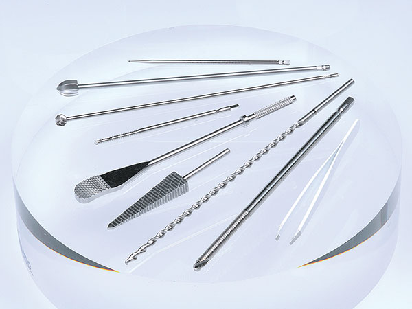

Some of the medical devices produced on Rollomatic tool grinders. (Provided by Rollomatic)

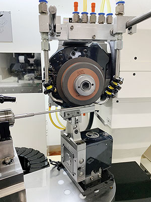

Grinding a flute on a medical drill at Alden Tool using a Rollomatic GrindSmart 630XS. (Provided by Alden Tool)

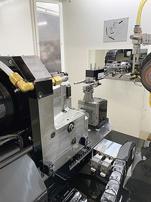

Side view of the loading area of one of Alden Tool’s Rollomatic GrindSmart 630XS machines. (Provided by Alden Tool)
“That brings challenges to the workholding and to the type of grinding that we apply to the tool,” said Schwarzenbach. “Sometimes they come to the grinding process with more runout than you would see [in an industrial] drill. [The medical community] needed to find a solution so that these long and thin parts could be, first of all, held in workholding for grinding with a consistent result, but also an automation solution so that those parts could be loaded and unloaded without any operator intervention in unattended mode.” Since long, thin stainless steel tools tend to be weak, any deflection during grinding will result in size inconsistencies. Finish is also critical. A bad finish will generate heat, “and in orthopedic procedures, anything above 50°F [10°C] at the tool alters the structure of the bone negatively,” said Schwarzenbach.
The solution Rollomatic developed concentrated on workholding, using a carefully chosen collet for driving the tool—a V-block to hold consistent concentricity with a steady rest that captures the part during grinding, according to Schwarzenbach. “When Alden came to us, we had a ready-made solution that Alden took advantage of,” he said.
