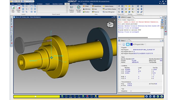

James Wardell gets a little credit, too. The programming technology manager at Conroe Machine, Wardell was part of the team that implemented VERICUT toolpath simulation software; without VERICUT, the company’s machining operations would be less efficient, less safe, and much less predictable.

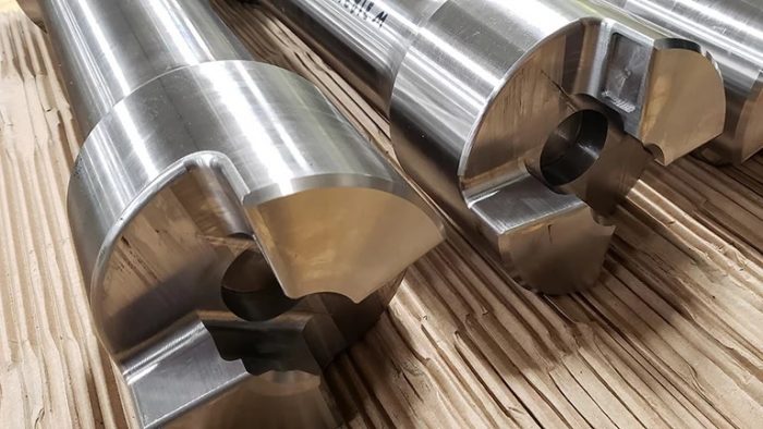

Conroe Machine produces many components for directional drilling of oil and gas wells.

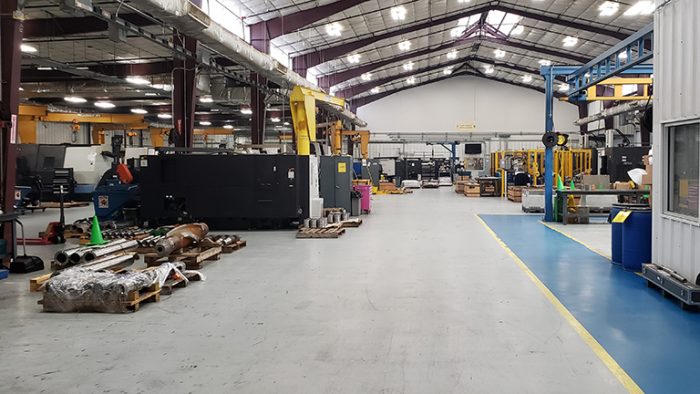

As Wardell pointed out, Conroe Machine produces much more than mud motors. Since 2000, this 160-employee, 65,000 ft2 ( 6,039 m2) facility in Conroe’s North Industrial Park has machined a wide array of high-precision parts for the likes of Halliburton, National Oilwell Varco (NOV), and Global Drilling Support International. These parts include subsea components such as stab plates and various control valves, many made from Inconel, Nitronic 50, ToughMet, and other challenging materials, but the company also has extensive fabricating and engineering capabilities.
“We make bearing races, housings, and PDM transmission parts by the hundreds of thousands, but we also do a lot of low-volume and prototype work,” Wardell says. “Much of what we do here centers around the oil and gas industry. After the last downturn, though, we’ve tried hard to diversify our customer base, and have expanded our service offering accordingly.”

The shop had plenty of other reasons to purchase VERICUT. Conroe Machine boasts an impressive array of CNC machine tools, including an Okuma LU45 II four-axis lathe, Doosan DMV 5025 and 3016 machining centers, a 120″ (305-cm) Mighty Viper 3100 vertical milling center, and more. It was the tremendous crash potential that comes with five-sided machining, though, that helped convince the management team of the necessity for accurate toolpath simulation.

That was five years ago, and Wardell said VERICUT continues to prove its value every day. “We have not had any crashes due to programming error since implementing VERICUT. We have had a couple missed dimensions here and there—stuff that I might have fat-fingered or forgotten during programming, but that’s why I started using the AUTO-DIFF function in VERICUT: to make sure everything is where it’s supposed to be, and that I didn’t miss anything.”

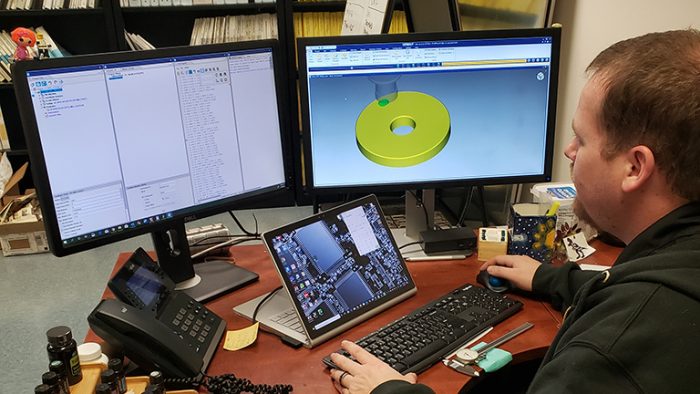

James Wardell, programming technology manager at Conroe Machine, was part of the team that implemented VERICUT toolpath simulation software.
Aside from crash avoidance, VERICUT also reduces setup times. Because the operators can see the entire program in advance, there’s less guesswork and less apprehension. Wardell hasn’t tracked how much time the company has saved, although he says it’s significant. “It simply takes a lot longer on an unverified program. The operator has to meticulously dry run each line, with his hands on the override and feed hold the entire time. With a VERICUT program, they can just go for it.”
