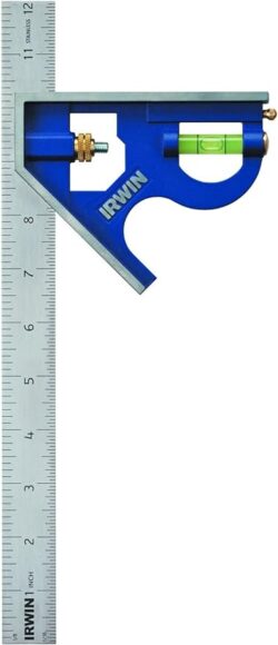

Right angle combination square
IRWIN Combination Square
Order Now
Chances are you have a combination square lying around, but if not, it’s time you get one as they are versatile and frequently needed in the machine shop. The combination square is used to align the table to the quill, when tramming the mill head. To learn more about the tools and see the different options on the market, check out our blog post The Anatomy of a Combination Square
