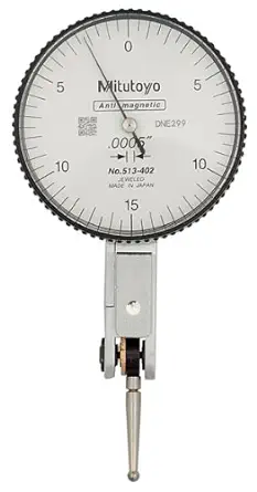

7. Dial Indicator
Mitutoyo 513-402, .0005″ X .030″ Horizontal Test Indicator, 0-15-0
Dial indicators are typically used to measure deck clearances, crankshaft thrust and straightness, lifter travel and other measurements that involve the distance between two surfaces or small amounts of component travel.  The most commonly used type of dial indicator reads in .001-inch increments over a range of 1 inch.
Here’s what we recommend.

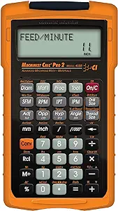

Calculator
Calculated Industries 4088 Machinist Calc Pro 2
Where there’s machining, there’s math. Luckily there are tools that can help make math easier and the most important one is a calculator. We recommend using a machinist calculator as it already has machining-specific keys, like surface feet per minute (SFPM), inch per tooth, inch per minute, and data about the most popular materials.
Here’s our favorite.

    It’s a common mistake, so I won’t beat you up for it, but the indicator you show as a “Dial Indicator” is actually called a “Test Indicator”. A Dial Indicator is the kind with the plunger that moves in/out of the body, and usually has much more travel than the Test Indicator.
