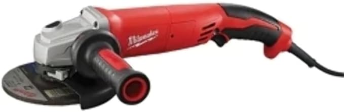

#3 Milwaukee 6124-30 5-inch Small Angle Grinder Trigger Grip, Lock-On
More durable and more powerful than most of its competitors. This Grinder allows the user to change all accessories without a wrench.
Angle Grinder, 5 In, No Load RPM 9000

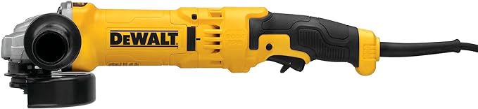

#1 DEWALT DWE43113 High Performance Trigger Switch Grinder, 4-1/2″ – 5″
Powerful and easy to use. This model features an adjustable disc guard that allows for easy adjustment or removal. Those who raved about this model commented on its durability, noting they have put the tool through challenging projects and its longevity hadn’t been sacrificed.
DEWALT Angle Grinder Tool
