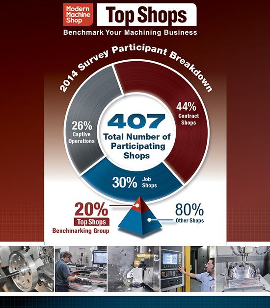

For this our program’s seventh edition, responses from 356 surveys were considered in the data calculations. The benchmarking group we established (the top 20 percent of shops based on tallying scores of select survey questions) is what we call the “Top Shops.” What’s exciting about this year is that, in addition to conducting another successful survey, we will be hosting our inaugural Top Shops Conference, September 5 to 7, in Indianapolis, Indiana, where we’ll present this year’s findings as well as host discussions about a range of machining- and business-related topics (see my commentary, “Top Shops: Live in Indianapolis,” for more information about the conference).
