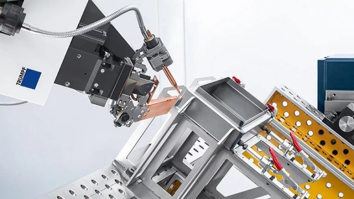

Trumpf’s Fusion Line features a laser assisted with wire to introduce more mass into the weld, bridging gaps up to 1 mm wide.

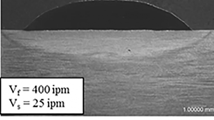

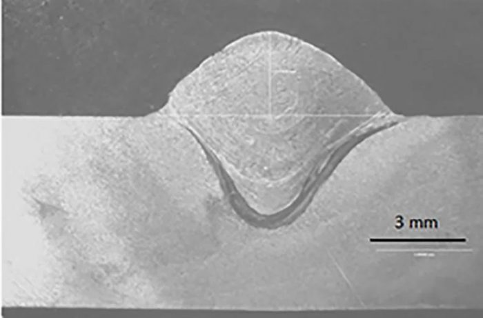

The dark area under the weld at left shows the deep penetration and complete fusion of a good MIG weld. The image at right shows a laser weld with complete fusion but very shallow penetration that reduces mixing between the filler and substrate.

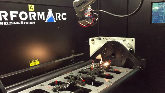

With its heat source standing off at a distance and a highly concentrated melt area below, laser welding seems like magic, as shown here in a Miller Electric system.

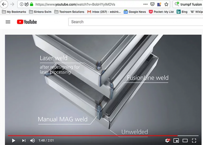

Comparing techniques: An un-welded joint at bottom, a MAG weld just above it, a Trumpf Fusion Line weld (which combines wire and laser) above that, and at top an autogenous laser weld after redesigning the joint for that process.
New Tech Combined with Old
Because autogenous laser welding requires a tight fit between the parts to be joined, in many cases it is best to redesign the joint locations to present overlapping surfaces to the laser (to use its piercing capability). More manufacturers are willing to invest in better upstream processes and tooling in order to take advantage of laser’s higher throughput.
But for those that are resistant to such change, or in situations where gaps are unavoidable, there are hybrid systems that combine laser and wire feed technology and other new developments that broaden laser’s applicability. One simple concept, (mentioned earlier with reference to solving the hot cracking problem) is wobbling the laser spot. Miller said it’s an old concept that has recently become much more economical. He offered the example of moving a 1.2-mm diameter spot back and forth over a 3-mm area at high speed, effectively capturing the larger area and still making a good weld.
Hansen said hybrid systems combine the MIG process and a laser beam. “We’re really using the laser to achieve penetration. Normally, if you want to affect penetration in a MIG weld, you have to add more amperage. By using the laser to do the penetrating, we can dial back the amperage on the MIG and use the smallest weld that our structure will allow for engineering purposes. So the laser allows us to optimize the MIG.” There is also synergy between the processes due to the laser beam stabilizing the arc. “We can travel with the arc much faster than we could if we didn’t have a laser beam. That’s how we’re able to go so fast with the hybrid process,” he said.
Trumpf’s Fusion Line, which Harooni described as “a process laser assisted with wire to introduce more mass into the gaps,” can bridge gaps up to 1-mm wide.

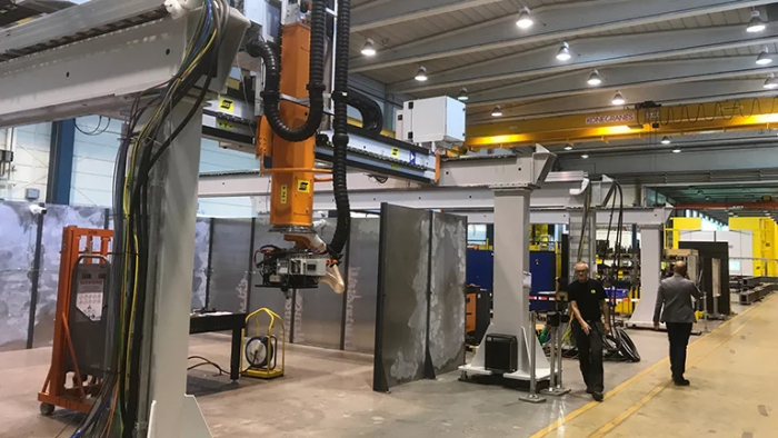

A set of large six-axis ESAB laser gantries for welding passenger rail cars.
For their part, ESAB developed adaptive welding technology that senses part conditions and changes the process parameters to suit them. The system uses a camera that “paints a laser stripe on the part and then looks at it from a parallax angle to see the shape of the joint, about 20-40 mm ahead of the process,” said Hansen. Laser coherent imaging is used to measure the keyhole being cut into the metal by the laser. “We can measure the depth of penetration and the shape of the keyhole and use that information either as a quality measure or in a closed-loop to control the process,” he said.
The system automatically adapts the laser penetration, laser power, gas metal arc parameters, wire feed speed, voltage, gas flow, and travel speed as the weld head processes through the part. The goal, which was driven by U.S. Navy requirements, is to bring the benefits of low heat input laser welding to “conventionally prepared parts” (i.e. parts that weren’t machined to tight tolerances for standard laser welding). Hansen reported that this broadens the process window for hybrid welding by a factor of five over what would have been possible with steady-state controls.
