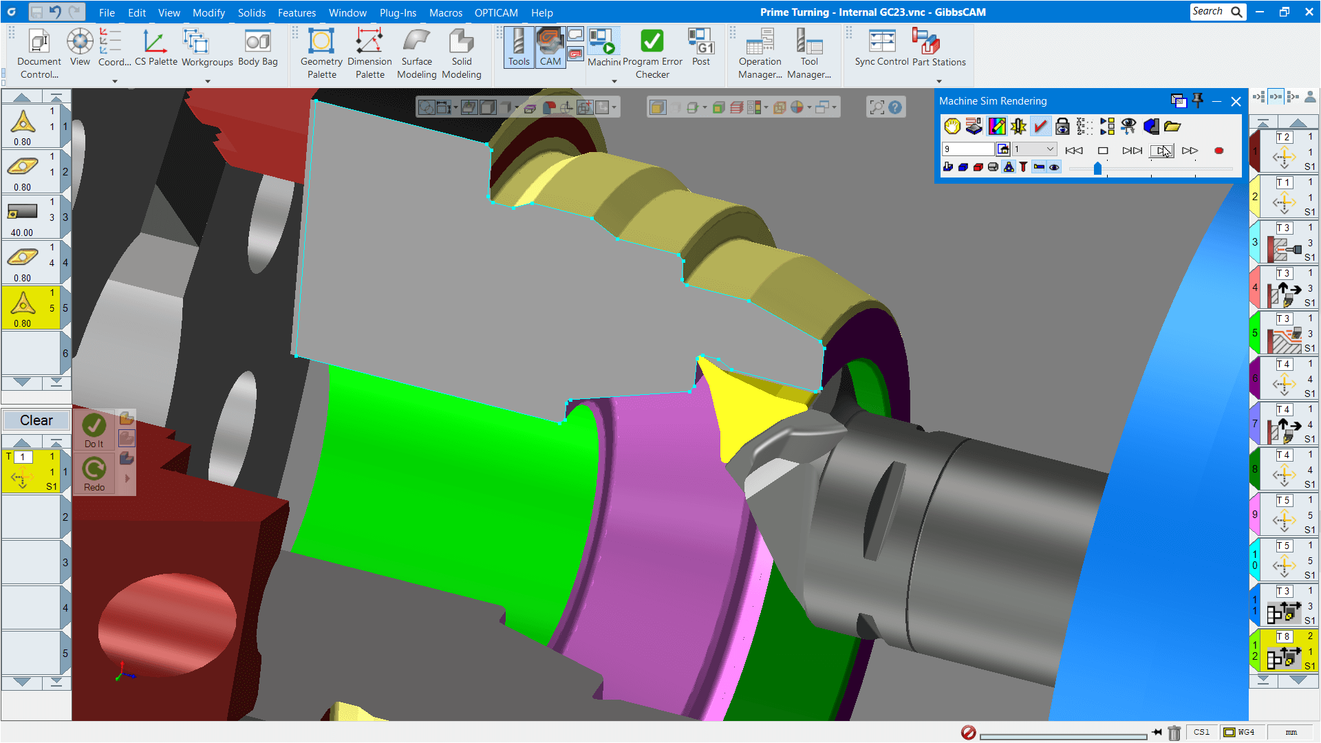

GibbsCAM 2023 features a number of significant Turning enhancements including the highly effective implementation of Sandvik Coromant’s PrimeTurningTM strategies. These new cutting methodologies permit turning and facing in all directions, delivering dramatic increases in high volume production. PrimeTurningTM has proven to deliver cycle time reductions of up to 50%, and more than 500% increase for insert tool life. PrimeTurningTM uses the slope of the insert for chip thinning to allow you to make heavy cuts and spread cutting forces and heat over a larger portion of the cutting edge, which in turn contributes to longer tool life. In addition, PrimeTurningTM adapts the feed rate (excellent for cutting on a taper) to constantly manage chip thickness which is ideal for high-volume and unattended environments. PrimeTurningTM supports two new tool types (CoroTurn® Prime Type-A with three 35° corners for finishing and fine roughing / getting into grooves etc, and CoroTurn® Prime Type-B with two strong corners for bulk roughing / heavy cutting) that both utilize a low lead angle to improve surface finish.
GibbsCAM 2023 introduces Sandvik Coromant’s PrimeTurning™ strategies
Commenting on the latest development, Åke Nilsson, Global Product application manager for Turning tools at Sandvik Coromant AB says, “we have now extensively tested the PrimeTurningTM cycle in GibbsCAM, and it’s really good. The team have taken an innovative approach and I must say that they’ve made a tremendous job with the technology implementation”.

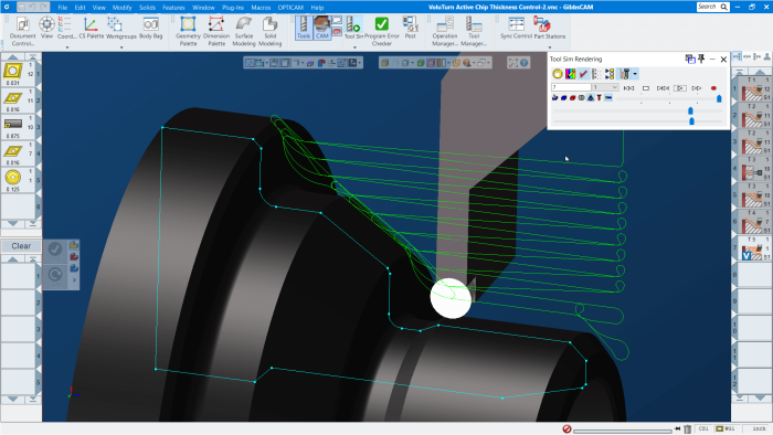

Other enhancements include a new option in most Turning processes to control Cutting Load Variation in order to suppress resonance-induced chatter and improve chip breaking for CNC machines. This machine capability is also called variable spindle speed by Okuma, and low frequency vibration by Citizen. VoluTurn functionality has also been extended to manage the active control of chip thickness during the cut by varying the feed rate instantaneously with any changes in cut depth.

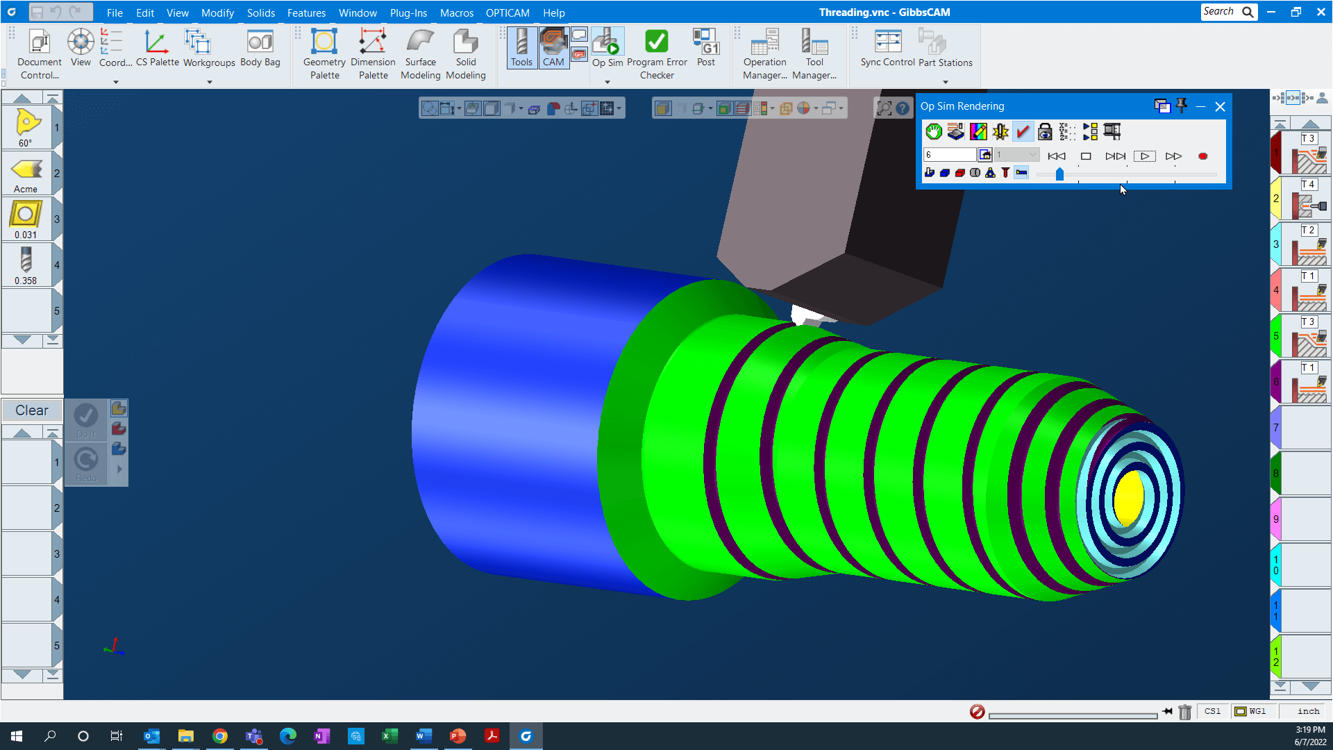

Thread Turning operations have been expanded with Face Threading, Variable Pitch Threading, Multi-pitch, and Position Tool Front options. Users can produce a spiral thread on the face of a part, vary pitch threads incrementally per revolution, or generate different pitches on a continuous thread, with easy control of exact start/end specs in the tool dialog.
Variable pitch threading applied to the face and outer diameter

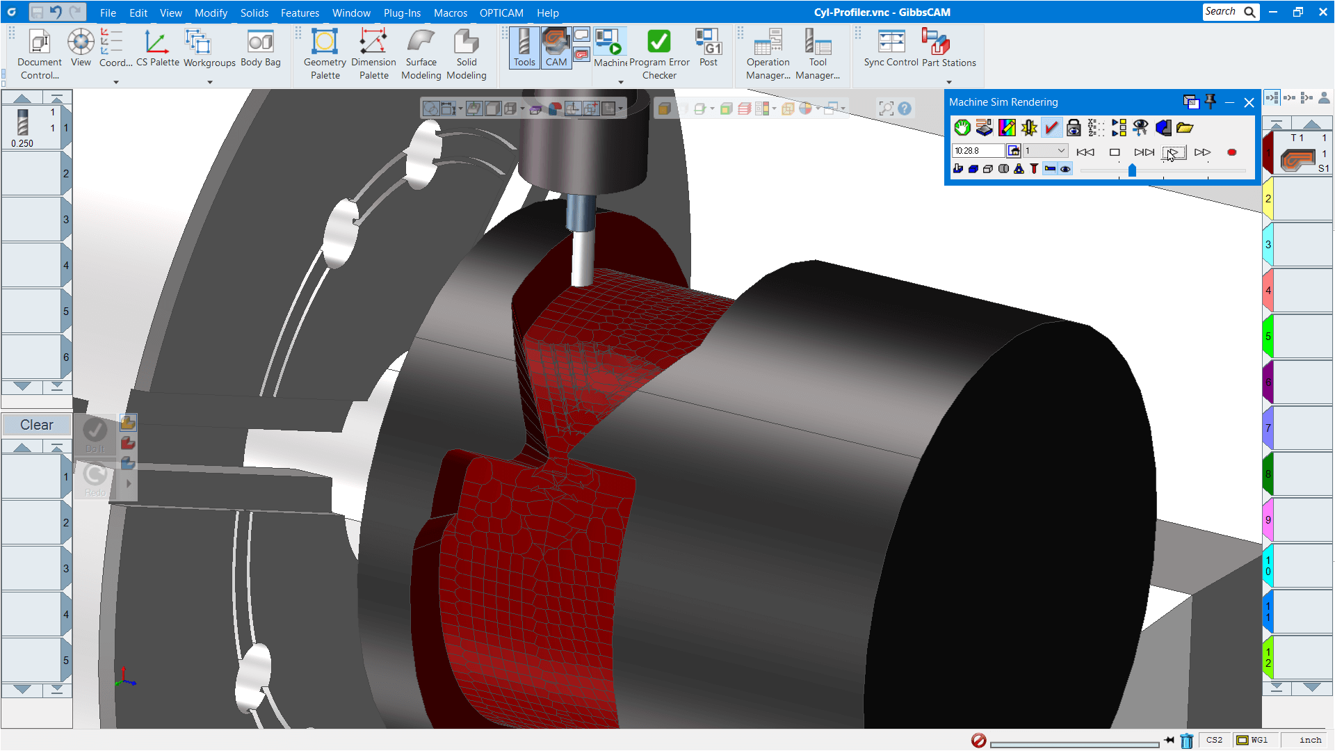

Cylindrical milling in GibbsCAM 2023 is easier with direct selection of a “Slice” in the CS depth axis — select a closed profile to machine a cylindrical boss or pocket, or select two loops to machine a groove or ring without the need to extract edge geometry and unwrap the shape. New Spiral Boring functionality cuts a spiral out to the full diameter at each Z step, which substantially increases cutting feed rate and depth due to a more consistent tool load. In addition, Mill Roughing can now omit cavity areas to support high-speed mill tools that cannot plunge or ramp.
Simulation of Cylindrical Milling from a profile in Slice mode

Active Chip Thickness Control in VoluTurn for optimized feedrate
