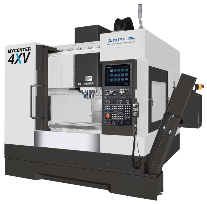

Kitamura Machinery, the premier manufacturer of precision horizontal, vertical and 5-axis machining centers, brings to market a new standard in VMC value – The Mycenter-4XV.   Designed with the flexibility of today’s job shop in mind, they Mycenter-4XV is truly big on features and equipped with a 19.7” x 44.1” table and 40.2” x 20.1” x 20.1” X,Y,Z travels making it ideal for large single workpieces, multi-fixtured components or additional axes implementation. “Best in class” 40T ATC assures smooth and effortless tool changes and offers greater flexibility for a wider variety of jobs, boosting productivity and machining profits.  A powerful, high speed, dual contact, 15,000rpm, 41 HP spindle system offers optimum rigidity and stiffness for demanding cutting conditions and handles hard-to-machine materials with ease.
Mycenter-4XV Features
Heavy duty cross linear guides, fine pitch ballscrews, high grade servo motors, feedback encoder and Kitamura’s high precision assembly technology allows for the highest accuracy and smoothest possible motion on the X, Y & Z axes.  Highest grade Meehanite cast construction provides optimum damping capacity and vibration absorption.  Kitamura’s exclusive intelligent advanced control system (IAC) consists of a series of strategically located sensors and machine efficiency monitors that work together to control the effects of heat displacement in order to ensure continuous accuracy in machining. ±1 μm repeatability is achievable.
A large ergonomic work envelope with wide door openings makes for easy load and unload of parts while high speed rapid feed rates of 2,047ipm (X&Y), 1,890ipm (Z) boost throughput.    Standard base wash system, internal chip augers, covered X & Y axes and a scraper type chip conveyor offer excellent chip management, keeping the workspace free of chips and contaminants. The flexible conveyor configuration allows for the placement on either the left or right-hand side of the machine.
Equipped with Kitamura Arumatik-Mi Pro control, the Mycenter-4XV comes fully loaded with many productivity boosting convenience features that are considered optional on competitive machines.  A large 15” touch screen color LCD, 5120 meters (2MB) of memory, high-speed, high-accuracy control with 8190 block look-ahead and 4,500 block per second processing speeds, and Super Smooth Surface (SSS) control are just a few of the many standard features incorporated to streamline the machining process for outstanding part quality with exceptional surface finishes.

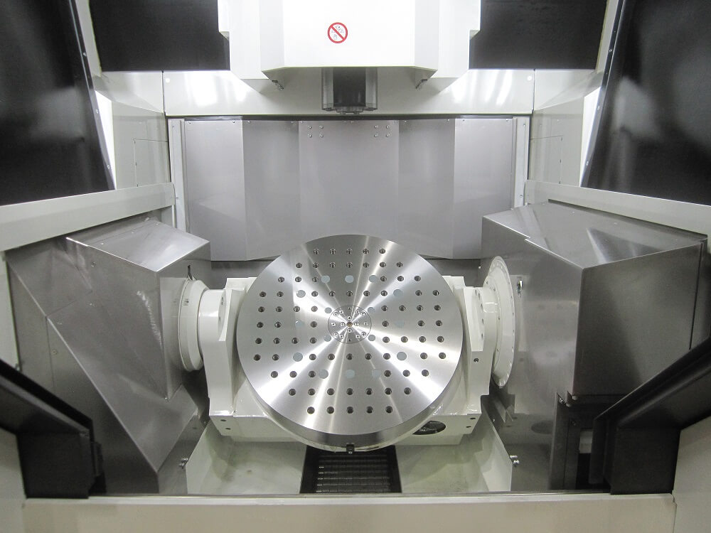

Kitamura’s compact V-Series VMC’s offer a wide and versatile model range from 3-axis verticals to 5-axis (4+1) configurations with integrated trunnion tables offering the rigidity, accuracy and stability needed to productively machine the most complex part geometries.
