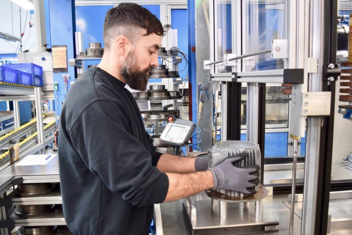

First step: The operator places the empty housing in the custom-fit workpiece carrier and then pushes it inside the UNI HEAT.
After starting, the component is lifted and encloses the inductor when it reaches its processing position.

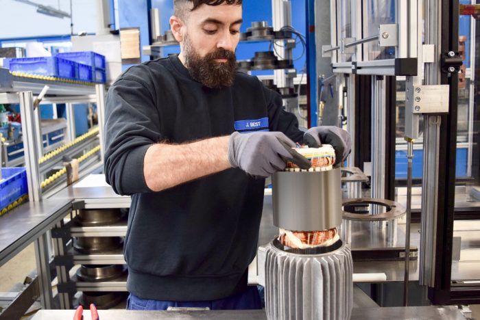

Last step: The motor winding is inserted into the heated (and thus expanded) empty stator housing.

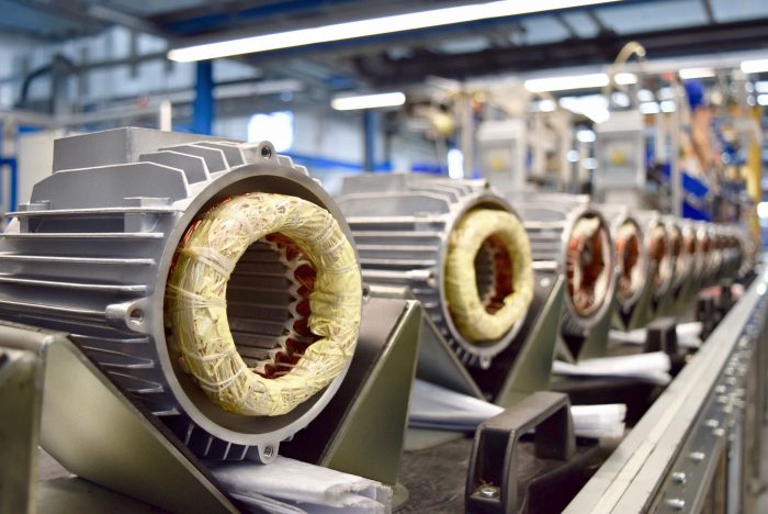

About 250 fan motors are produced every day at Elektror’s production site in Waghäusel.

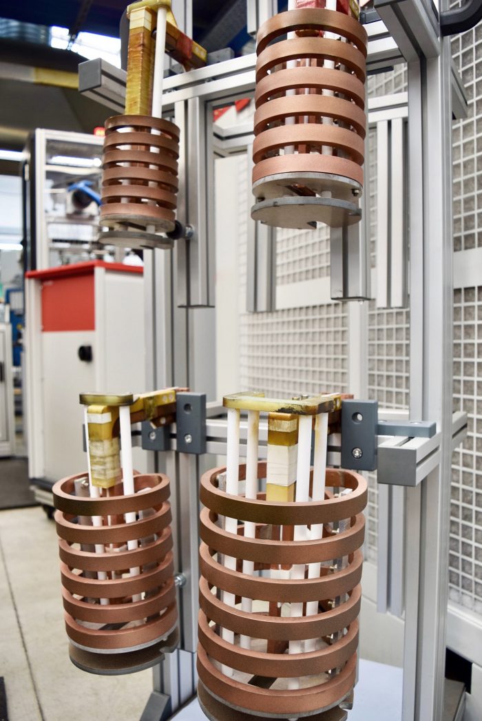

The component sizes change on a very regular basis. That is why the UNI HEAT is very easy to retool. Elektror has various sizes of inductors available for the empty stator housings.

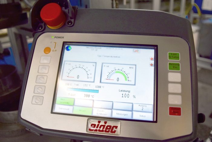

Among others, the UNI HEAT’s control unit displays the component’s actual temperature during the heating process.
