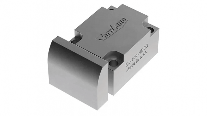

Spring stop buttons are available with a spherical contact button, flat face, or flat face with tag.
Spring stop buttons are another commonly used spring-loaded device. These units work much like spring pins, but they are designed for parts where more travel or force is needed. Spring stop buttons are made with three different contact faces. The first is a spherical button contact; the other two have flat contacts. The flat-face contacts are made either with or without a tang.
