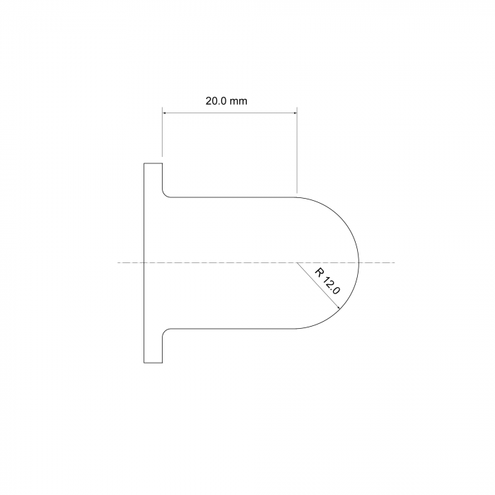

The best way to explain subroutines is with an example. Let’s take a look at how we can write a roughing and finishing cycle on a CNC lathe writing the profile once.
The Roughing Cycle
This block of code will turn a 12mm spherical radius and turn a 24mm diameter at 20mm length.

Below is the full program of the roughing cycle and finishing cycle that makes use of a subroutine. This program produces a 12mm spherical radius and a 20mm long by 24mm diameter feature. As shown in this drawing.
