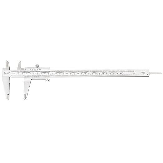

Starrett 125MEA-8/200 Vernier Caliper
Featuring both inch and metric measuring range and 0.001″/0.02mm graduation, this Starrett model is great for measuring the inside and outside diameter of holes, grooves, and tube thickness, along with the depth and step measurement of bores and grooves. This tool is durable and wear resistant thanks to its hardened steel depth rod.
