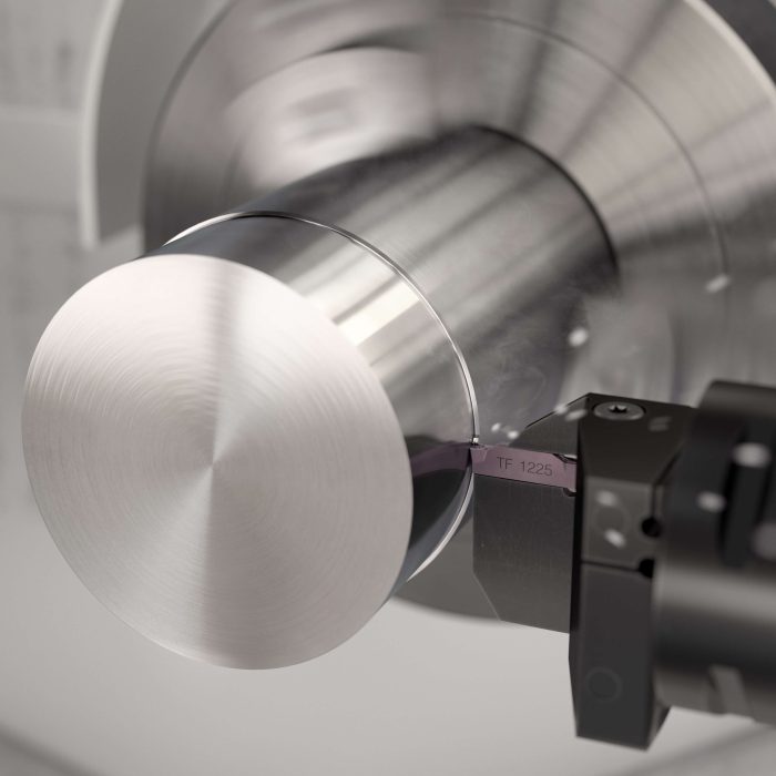

Stability is key when working with all parting and grooving operations. The main challenge is keeping the insert in place to minimize all forms of insert movement. The well-established rail interface, previously available on medium and large inserts, offers more precise insert positioning and makes the insert resilient to any lateral forces exerted on it. This rail interface will now also be available on smaller insert sizes, guaranteeing stability in all operations.
CoroCut 2 parting blades are upgraded with internal coolant and an improved clamping finger design, which offers a higher clamping force and better side stability — a welcome advantage when making chamfers before parting off. Tool holders with precision coolant are updated with a screw clamp solution, which — combined with the rigid rail insert seat design — keeps insert movement to a minimum without any loss of clamping force.
Other important features included in the upgrade are new and updated grades and geometries, including the new first choice grade GC1225, a wiper design for all parting geometries and greatly enhanced edge line quality on all inserts.
“What makes this solution unique is the in-house developed and patented production technology,” says Fredrik Selin, product application specialist at Sandvik Coromant. “With better blank quality from our new production technology, we achieve less spreading of the edge line. This means we can have a lower tolerance and perform smaller edge rounding than before, with a longer, more predicable insert tool life as a consequence.”
