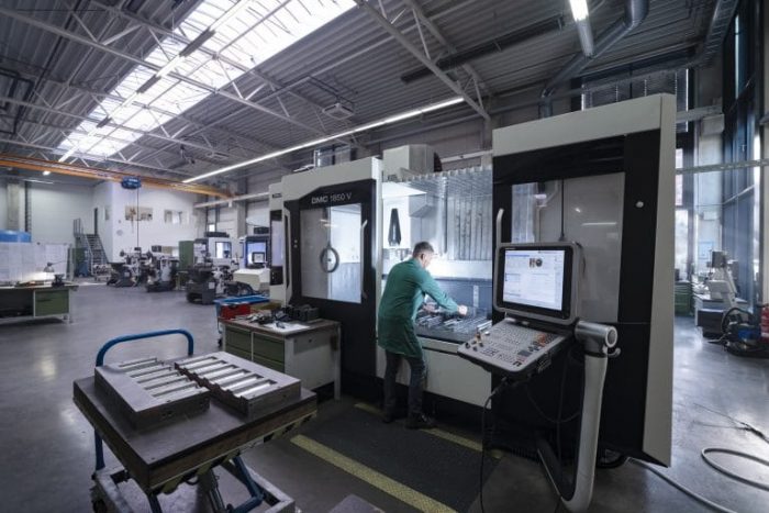

The DMC 1850 V shown here is the largest of Werkzeugbau Leiss’ fleet of DMG Mori VMCs. (Provided by DMG Mori)

The largest model of the DMC V series was installed in July 2018 as a field test machine, which Daniel Leiss considers to be the perfect addition: “With the DMC 1850 V, DMG Mori has adapted a tried-and-tested machine concept to the increasing quality requirements when machining larger and heavier components.” The vertical machining center expands to 1,850 mm travel paths in the X axis, and 700 mm and 550 mm respectively in the Y axis and Z axis. The maximum load capacity is 3,000 kg.
According to Daniel Leiss, the DMC 1850 V ideally matches the mold and die maker’s requirements. “Machine stability applies both to 2.5D machining and drilling as well as to 3D roughing. With its accuracy and dynamics, the machine is also impressive for 3D fine finishing and is therefore suitable for use in all phases of tool production,” he said. After only a few months of field testing, the DMC 1850 V was being used in a two-shift operation and has been performing reliably since.

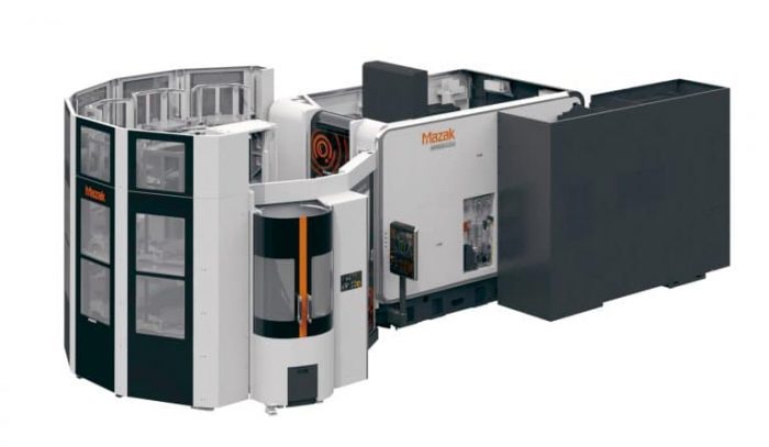

When it comes to automation, machine tool OEMs, such as Mazak, realize that one size does not fit all and continue to develop scalable automation systems. Such systems are scalable in size, cost, and capability, yet provide the typical benefits of any form of automation—increased output from machines and labor—essentially doing more with less.
Here’s how Mazak sizes up the benefits of single-machine automation. Compared with more expansive automation systems, single-machine automation systems have dramatically smaller footprints, and in many job shop cases that is all that is needed.
Today’s single-machine automation systems are typically standardized solutions, yet flexible and expandable. For instance, Mazak’s Multi Pallet Pool (MPP) automation system gives shops the option of three different configurations, holding 6, 12 or 18 pallets. The system works across different production methods and the operator can set the MPP system to run low-mix/high-volume parts or short-run parts with frequent changeovers.
Initially, a shop could start with a six-pallet MPP com-posed of two rows of three pallets. This two-level system could expand to six pallets on each row for a total pool of 12 pallets. For an 18-pallet system, the MPP would grow to three rows of six pallets. Regardless of configuration, the MPP’s size in terms of footprint remains small, saving valuable shop floor space.
An MPP six-pallet changer paired with a Mazak Variaxis i-600 five-axis VMC, for example, uses 29 percent less floor space than a six-pallet linear-type system while providing the same capacity. Compared with a 12-pallet system, the MPP reduces floor space requirements by 44 percent. And when used with a Mazak Variaxis i-700 five-axis VMC, a six-pallet MPP is 44 percent smaller than a six-pallet linearly arranged system, and the MPP’s 12-and 18-pallet systems need less than half the space.
In contrast to other automation systems, the MPP uses actual machine pallets instead of additional ones placed on top of a machine’s existing pallet. The Variaxis i-600’s MPP features a 400 sq-mm pallet that holds a 300 kg maximum load at dimensions up to 600 mm in diameter and 425 mm in height.
The Variaxis i-700 MPP pallet is 500 mm square and has a load capacity of 400 kg. The MPP operates with the same pallet clamping system as would a typical two-pallet changer installed on a machine tool. Within the MPP, a servo-driven robot picks and places pallets in and out of the machine.
The MPP uses the same Smooth PMC software that controls Mazak’s extensive, multi-machine Palletech Automation System. The machine tool’s control displays the software that runs on a separate cell controller unit. Smooth PMC software makes it easy to monitor the automated machining system from almost anywhere using a smartphone, PC or tablet. The software also lets shops change schedules on the fly, manage part program files, track tool life/breakage as well as issue instructions to the shop floor.

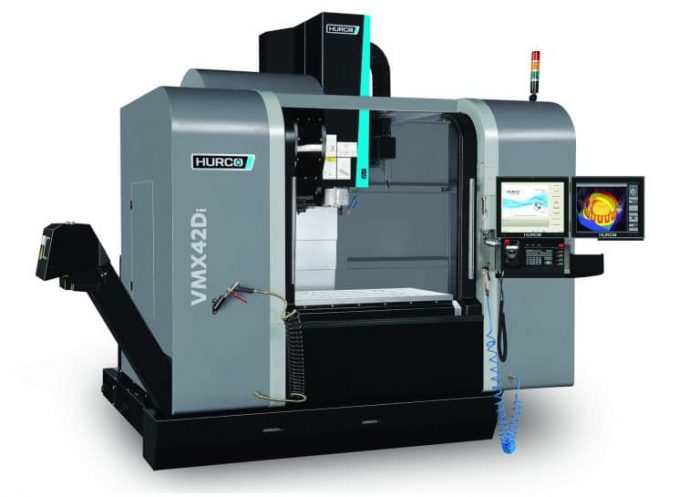

You would expect that Hurco Companies Inc., which invented conversational programming, would be a leader in streamlining the process of getting from print to part faster with CNC machining centers. And it is.
Hurco VMCs run the gamut, from the VM CNC VMC compact footprint value model to VMX five-axis series machines, and for the largest aerospace parts the DCX series of double-column machining centers with 2- and 3-m X axes. Hurco’s VMCs are used to manufacture parts for the automotive, aerospace, medical equipment, energy, injection tool and mold, transportation and electronics industries.
On its higher-end CNC machining centers, Hurco offers dual-screen control for faster, easier processing. A Data Block Search helps operators edit a part program to correct a feature, for example. Instead of searching through lines of code, the programmer uses the graphics screen to select the part feature that needs to be edited and the corresponding line of code appears on the other screen so that the change can be made quickly.
CAD images can be imported, desired features selected, and a program automatically created by the WinMax CNC. The part program can be checked with Hurco’s verification graphics. (Provided by Hurco)
Hurco’s Concurrent Programming feature is enhanced with the dual-screen control. While the machining center is running one part, the operator can program the next part without interrupting the machining cycle.
DXF Transfer allows the operator to import the CAD image, select the desired features, and the WinMax CNC control automatically creates the program. The part program can be checked on the screen with Hurco’s verification graphics system, which includes 3D solid rendering of the toolpath with dynamic rotation and real-time tool display so that the part can be viewed from any angle without being forced to re-draw it.
Recent Hurco control and software features are designed to streamline everything from optimizing cycle time to capturing tooling information. UltiMotion reduces cycle time by up to 30 percent which, according to Hurco, significantly increases surface finish quality.
UltiMonitor allows remote monitoring of the machine from any web browser, or it is possible to see the control screen or video from a USB camera at the machine. Absolute Tool Length allows tool setup to be independent from the part and machine. As a result, tool information only needs to be captured once, allowing the tool to be used on other machining centers, facilitating the use of an offline tool presetter. In addition, Tool Change Optimization analyzes the part program and automatically reduces the number of tool changes by rearranging the program for optimal efficiency.

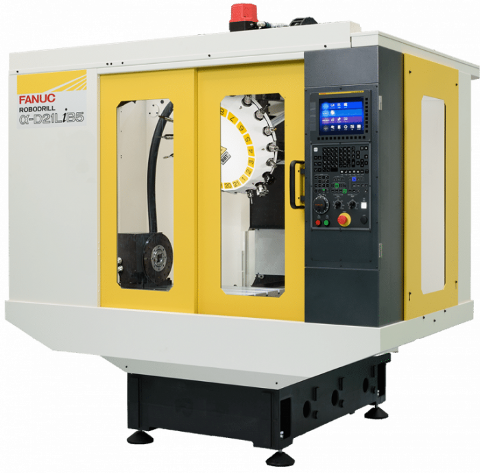

The familiar FANUC RoboDrill mimics a vertical machining center’s ability to perform milling, drilling, tapping, facing, pocketing and slotting—everything that a VMC can do, said Ken Corklin, RoboDrill product manager, Methods Machine Tools Inc., Sudbury, Mass.
“The RoboDrill competes very well with 20 x 30″ and 20 x 40″ VMCs and can do the same amount of work as a 40-taper 20 x 30″ VMC and do it 15-50 percent faster. Reasons are fast tool change, fast spindle on and off, and high acceleration rate motors. Even if a 40 taper can do some heavier roughing, the RoboDrill beats them in slotting, tapping, drilling, pocketing and circular interpolation. With roughing, the RoboDrill is usually 15 percent faster; without roughing as much as 20-40 percent higher,” he said.
There are over 7,000 RoboDrills installed in North America, with about half in job shops and half in industry-specific shops. Applications include high-speed machining of aluminum for aerospace parts, titanium and cobalt chromes for medical parts and gun parts as well as general engineering.
“BIG Plus spindle technology has given the 30-taper C-frame style RoboDrill the surface contact area that enables it to take heavier, high-quality cuts and do it at lightning speeds—something that 40-taper machines have trouble matching,” said Corklin. “For example, RoboDrill is able to do typical mold and die work or medical applications with a high-speed ball end mill with feed rates of 200 ipm (50 m/min) or more because of its fast acceleration/deceleration rates.”
The RoboDrill mimics a VMC’s ability to perform milling, drilling, tapping, facing, pocketing and slotting. (Provided by Methods Machine Tools)
RoboDrill is available in three sizes: short bed, medium bed and long bed with the latest FANUC 31i-B5 Nano CNC control. X/Y/Z travels in the short bed model are 300 x 300 x 300 mm; 500 x 400 x 330 mm in the medium model; and 700 x 400 x 330 mm in the long bed. Rapid traverse rates are 2,125 ipm (54 m/min) in all three models. BIG Plus spindles are 10,000 rpm and 24,000 rpm with a 21-tool ATC.
The newest additions to the RoboDrill include a servo motor for the turret, which reduces cycle time, as well as features like Ai Overlap, which allows arc radius moves in the Z axis for reduced cycle time instead of 90º corners requiring a stop. A touchscreen iHMI control from FANUC allows for growing use of apps, such as Renishaw’s Go Probe.
RoboDrills are designed to match seamlessly with FANUC robots for standard automation packages or for customized automation solutions. Methods has a number of standard “bolt-on” automation solutions in the new Plus Series, including the Plus K.
The Plus K allows the RoboDrill to run unattended through an extended automatic tool changer and an automated pallet changer. Custom automation solutions have been a focus of Methods Automation for years, according to the company.
With the FANUC 31iB5 control, the RoboDrill is five-axis capable. Options such as AICCII and thousand block lookahead make it capable of high-speed contour-ing and machining. Its size and 1.5 g acceleration make it highly maneuverable and capable of cycle time reductions of 15-50 percent compared to standard VMCs, according to Corklin.

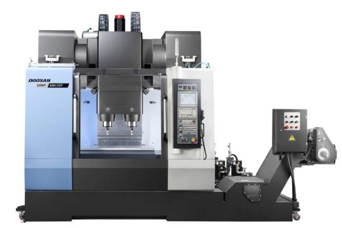

Many machine tool builders now lean exclusively toward linear guideway machines. But Doosan Machine Tools America, Pine Brook, N.J., offers both linear and box way VMCs, providing a wide range of machining options.
The DNM Series features linear guideways, BIG Plus 40- and 50-taper spindles (which come standard on Doosan VMCs), and spindle speeds from 8,000-15,000 rpm. The S model is equipped with 15,000 rpm and faster rapids. X-axis travels range from 20.5″ to 85″ (520-2,160 mm) in the model lineup.
For heavier machining in harder materials, the Mynx Series features box way design, BIG Plus 40- and 50-taper spindles with either geared head or direct drive, depending on the model, and 6,000 to 12,000 rpm range.
The Doosan DMP 500/2SP has twin spindles and two tool changers. (Provided by Doosan)
For production shops, models include the VC Series with rotary pallet changers, and the DMP 500/2SP with twin spindles and two tool changers. The DMP has a 47.2 x 20.5″ (1,200 x 520-mm) table and an up to 40-tool magazine accessible by each spindle in about the same footprint as a single-spindle machine. Each spindle can be adjusted slightly with the W axis to avoid the need for perfect alignment of workholding or fixture heights.
Doosan’s five-axis verticals include the DNM with two-axis trunnion tables integrated into the machine platform. With a rotary table paired with a direct drive, 40-taper, 12,000 rpm spindle, the machine offers a step up from a standard VMC.
Finally, DVF five-axis machines offer a more fully integrated solution, with either a cantilever-style five-axis or a trunnion-style table. VCF Series five-axis fixed table VMCs offer more in part range since the machine travels and table size are larger. The additional axes are in the B-axis rotating head spindle or in the built-in, above-table rotary axis.
