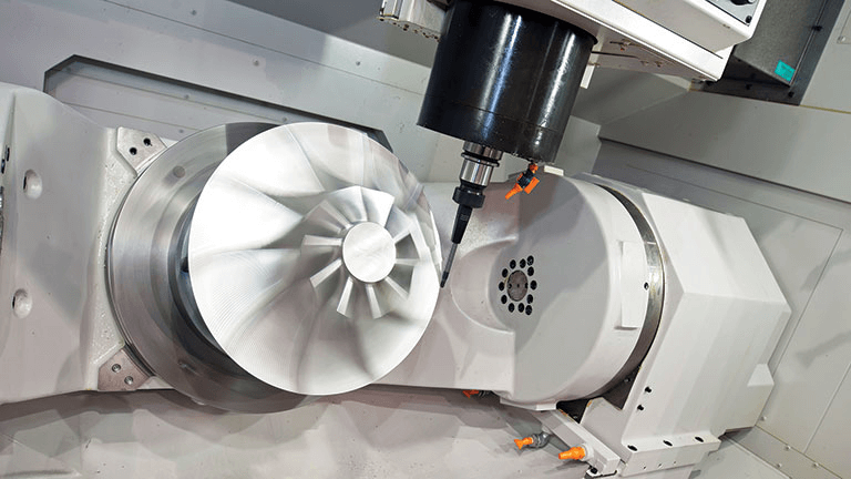

Five-axis machining centers, such as this Okuma MU-5000V-L five-axis VMC, allow shops to machine highly complex workpieces in a single operation, reducing work-in-process while increasing part quality and profitability.

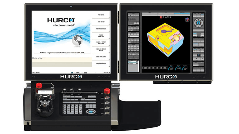

Development of Hurco’s MAX5 control console relied on testing with customers of varying skill levels, resulting in a combination of ergonomics and usability.

Five-axis also inspires more creative and productive ways to machine those workpieces. This is particularly true for moldmaking, Cope said, where the ability to tilt the spindle when milling deep cavities allows the use of shorter tools and circle segment cutters, a.k.a. barrel mills. This in turn produces a more rigid setup, with faster feed rates, deeper cuts, greater tool life, less chatter, and fewer of the surface finish and part accuracy problems that arise from the long, skinny tooling needed on three-axis CNC mills.

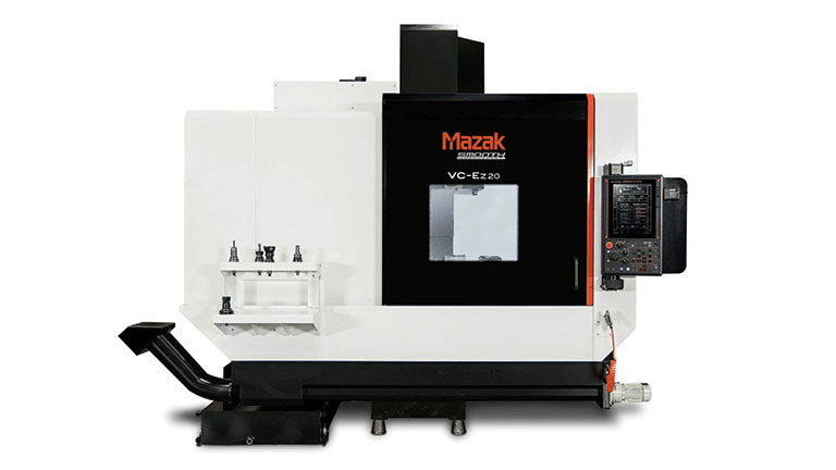

Much of this is due to the industry’s greater familiarity with three-axis mills, Kerscher added. For those of us who started their machining careers cranking the handles on a manual knee mill, the leap to its CNC counterpart is an easy one. “They’re easier to program and operate, something that’s very important given the current skilled labor shortage,” he said. “You can look at a drawing and visualize how the part is going to sit on the table, with the Z-axis moving up and down and the cutter going around and over the workpiece. This factor alone makes it easier to work on [a three-axis machine].”
Mazak’s recently introduced VC-Ez 20 three-axis VMC is powered by the company’s new MAZATROL SmoothEz CNC, promising performance and ease of operation at an affordable price.

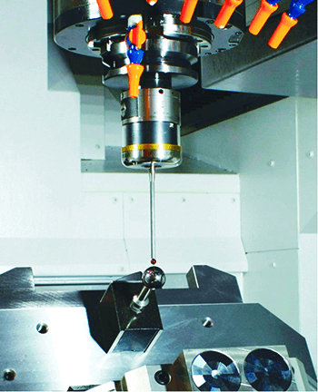

“Someone setting up a three-axis vertical might use a wiggler or edge finder to pick up a workpiece location,” Kerscher said. “On a five-axis machine, they’ll more than likely need a touch probe, and quite possibly one of those spherical ball devices from Renishaw or another provider to determine the axes of rotation. That’s not to say it’s terribly difficult, but it’s definitely a skillset progression that should be accounted for when investing in a new machine or hiring an operator.”

The good news is that five-axis machining center operation is getting easier all the time. That’s according to Errol Burrell, machine center product specialist for Okuma America Corp., Charlotte, N.C., who can lay claim to 25 years of five-axis experience. Not only are CAM systems becoming more “five-friendly” than they once were, he said, but machine tool builders have introduced automatic calibration systems that eliminate much of the guesswork described earlier.
“When I was first introduced to five-axis machines, you practically needed a degree from MIT to set one up,” he said. “You had to know the location of the rotary pivot points and the constant surface, which is your table, and the spindle gauge line, the tool lengths, and all these values had to be factored in when you generated the program. That’s not the case now with the invention of what Okuma calls tool center point control, or TCPC.”
Burrell explained that each machine builder has its own version of TCPC, but all do the same thing—make it easy to determine the part’s center of rotation. Most also offer features similar to Okuma’s dynamic fixture offset, five-axis autotuning, posture control, and more, all of which take the hassle out of five-axis. “We no longer care about all the stuff we had to deal with because it’s all calculated automatically in the background, either in the machine control or in the CAM system. It’s much simpler than it once was.”

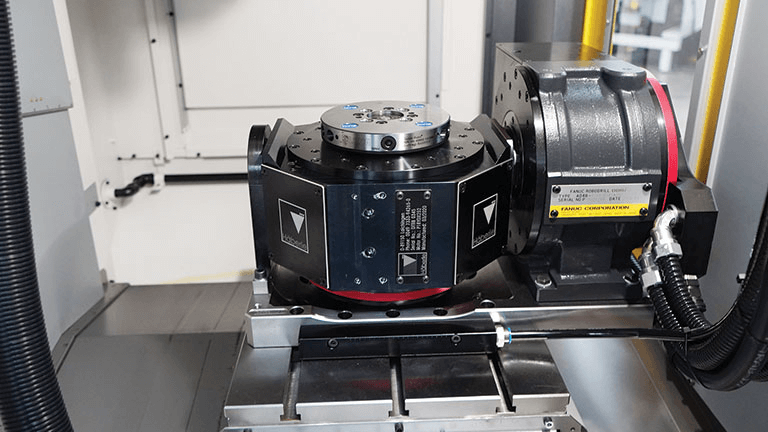

Investment in a new machine tool isn’t a prerequisite to five-axis machining. Burrell and several others interviewed for this article noted that many shops get their feet wet by first purchasing a rotary table for four-axis work, or a trunnion-style tilt-rotary for 3+2 and five-axis simultaneous machining. And while this is a good solution for some applications, it does present some caveats.
The first is that all of the five-axis niceties just mentioned don’t exist on a three-axis VMC. And while their lack might not require the operator to have the MIT education of Burrell’s early days, not having them will make setup and troubleshooting more challenging, enough so that competing with a true five-axis shop is unlikely.
The second is tool length. Given that a typical trunnion table can measure 14″ (35.56 cm) or more in height, the 20″ (50.8 cm) or so of Z-axis travel common on many vertical mills is quickly eaten up. Simply put, installing a tilt-rotary table on most VMCs is like putting a fish finder and trolling motor on an old Crestliner—you might catch a few crappies, but it’ll never be the Bass Cat you’ve been hoping for. “Rotary tables and trunnions are limited, but if you don’t have the cash or your needs are minimal, it’s still a good way to ease into four- and five-axis machining.”

Thomas Saur, vice president of FANUC America products at Methods Machine Tools Inc., Sudbury, Mass., suggested that the shift from three- to four- or five-axis machining is like a high tide rolling onto shore, adding that many of his customers invest in one of FANUC’s three-axis RoboDrill machining centers one year and add a four- or five-axis table the next. And because the machines are designed for such a transition, the limitations just mentioned don’t apply. Furthermore, these customers often add one of the company’s automation solutions at the same time.
Many customers of Methods Machine Tools invest in a three-axis RoboDrill one year and add a four- or five-axis table the next.

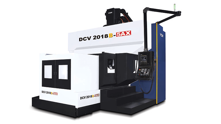

Tony Pekalski, president of Carson, Calif.-based YCM Technology (USA) Inc., said that success with any five-axis VMC depends on several factors, many of them already listed. These include operator skill level, the amount and type of work available for the machine, accuracy requirements, and more. Sitting somewhere near the top of this list, however, is the amount of material that must be removed from the workpiece.
“For heavy stock removal, a three-axis vertical is often a better choice, due to the fact that you generally can’t run the same feedrates and depths of cut on a trunnion,” he said. “On the flip side, you’re always better off from an accuracy perspective if you can machine as much as possible in a single operation, which five-axis machinery is obviously better at. These variables are why it’s important for any shop to partner with someone knowledgeable with all types of machine tools before investing in one.”
YCM’s DCV-series three- and five-axis machining centers have a double-column design that’s suitable for very large workpieces.
Pekalski elaborated on this statement, suggesting that a good supplier should not only understand the different applications for three-, four-, or five-axis machine tools, but also understand the different designs available within each. For example, YCM offers five different styles of five-axis machines. These include C-frame, bridge, ram, and gantry mills, each equipped with a trunnion, as well as double-column and gantry verticals with two-axis heads. A horizontal trunnion-style machining center is on the horizon.
Does it matter? Yes said Pekalski. “Aerospace, automotive, medical, energy, heavy equipment—there are so many different market segments out there, each with a wide variety of parts and materials, that it’s impossible to have one style of machine that does each one well. That’s why we have such a diverse offering, so as to compete in each of these markets.”
