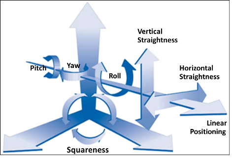

Volumetric Compensation is essentially an innovative method of assembling the volumetric map on a given machine. Up until now, a typical three axis machine has used the traditional 21 Error Parameter method to measure machine axis errors. Measurements were taken one at a time, along each individual axis, X, Y, and Z.
Each of the three axes has 6 error parameters, i.e. linear position, vertical and horizontal straightness, pitch, yaw, and roll. Each error parameter required a different set-up and each required its own measurement process. In addition to these 18 error parameters, 3 more error parameters determine squareness of each of the X, Y, Z axis to each other, X to Y, Y to Z, and Z to X for the total of 21 error parameters.
squareness
Even with the most sophisticated laser, this data acquisition is a long process and roll in the Z axis has to be determined by some other means. If the machine tool has additional axes, like a rotary axis, the calibration time increases rapidly.

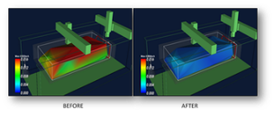

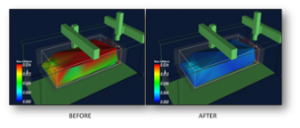

4. The calibration is then validated using the output from step 3 and another set of measurement data from the Laser Tracker and Active Target. Once this step is validated, the machine calibration results are loaded directly into the controller for real-time compensation.
before-after

[table]
[attr style=”width:20px”],CEC linear on all Cross-Axis off VEC (inches),CEC Linear on all Cross-Axis off VEC on (inches)
MAX,0.0123,0.0053
MIN,0.0014,0.0003
AVG,0.0065,0.0015
STD Dev.,0.0029,0.0011
,,72% improvement
[/table]
Customer: Aerospace
Machine: Two Large 5-axis machines
[table]
[attr style=”width:20px”],ADS5,NG Comp (inches),VEC Comp (inches)
,AVG,0.0051,0.0018
,,,68% improvement
,ADS4,NG Comp (inches),VEC Comp (inches)
,AVG,0.0082,0.0022
,,,75% improvement
[/table]
Customer: Aerospace
[table]
[attr style=”width:20px”],Rotating Table (BZXYA),Median (mm),Max (mm)
,Before,0.053,0.157
,After,0.036,0.069
,Rotating Table (XBYAZ),,
,Before,0.224,0.445
,After,0.030,0.104
,Gantry (XYZCA),,
,Before,0.381,0.737
,After,0.076,0.127
[/table]
