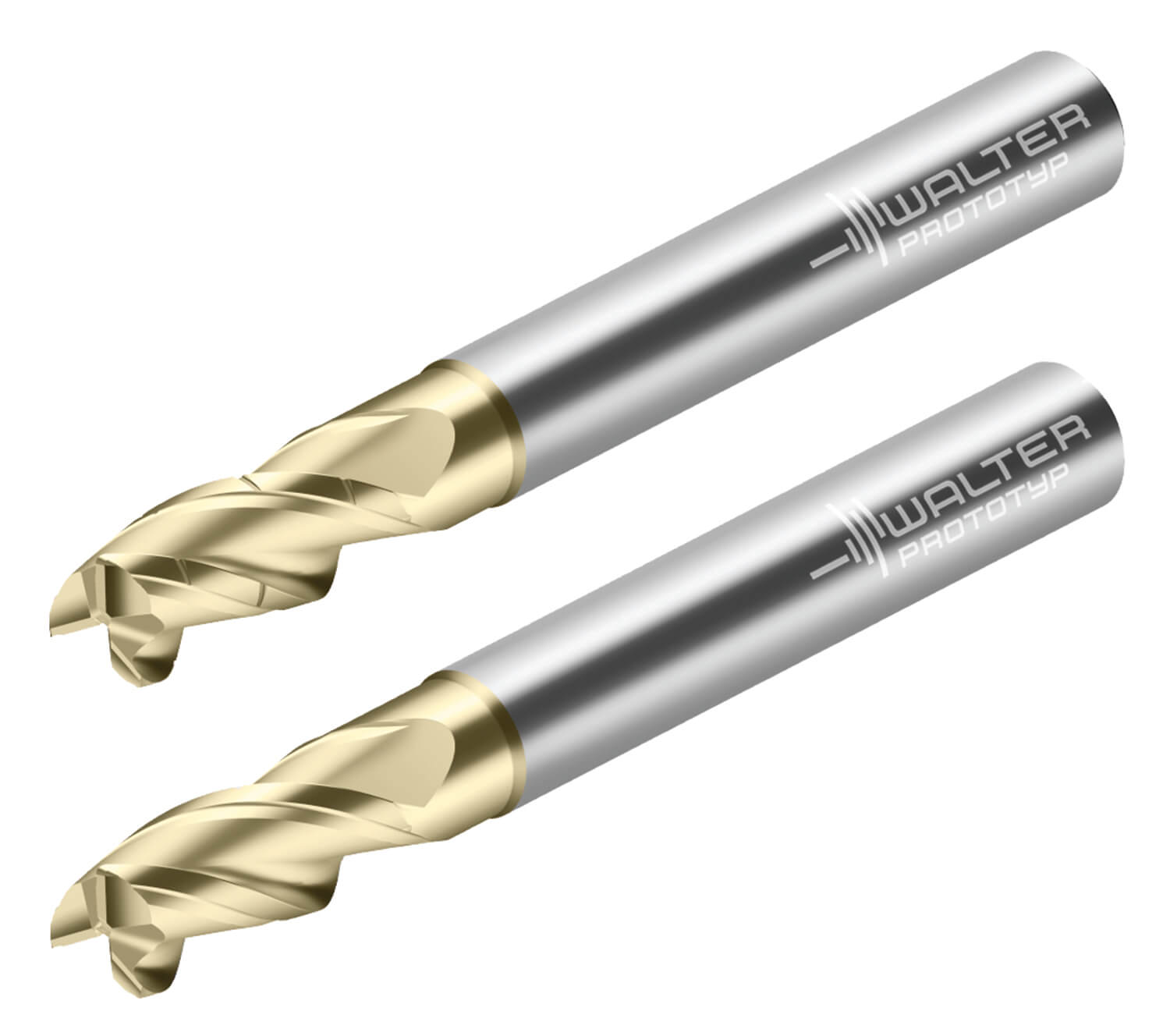

Walter (l to r) MA377, MA373, MA375, MD177, MD173 Supreme solid carbide milling cutters for difficult to machine materials.
