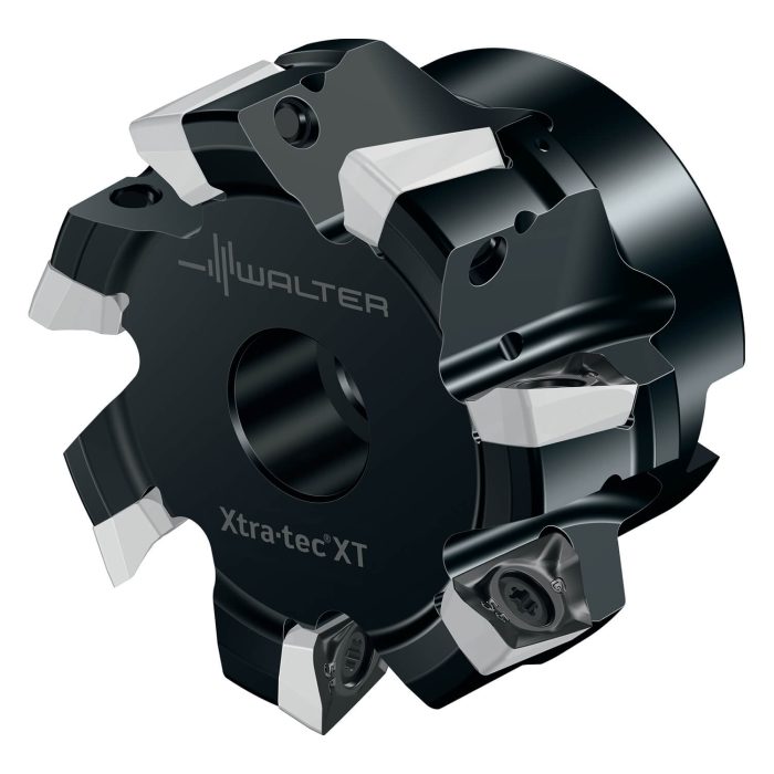

Tiger∙tec® Silver WSM45X indexable insert grade for the Xtra∙tec® milling cutters
The grade’s combination of a special carbide substrate that is wear-resistant yet tough and a unique aluminum oxide (Al2O3) chemical vapor deposition (CVD) coating ensures a high level of process reliability. The Tiger∙tec Silver coating effectively protects the substrate against excessive heat degradation and the extremely smooth surface reduces the formation of built-up edge, offering a high level of productivity. The two-tone coating also enables reliable insert wear detection.
The Tiger∙tec® Silver WSM45X is a proven problem-solver, particularly when roughing titanium aerospace components and milling stainless steel. WSM45X indexable inserts are frequently applied to machine exhaust turbochargers, turbine blades and titanium structural components for the aerospace industry.
To go along with the new indexable inserts, the Tiger∙tec® Silver WSM45X range also includes inserts for many other commonly used Xtra∙tec® XT shoulder milling cutters, high-feed milling cutters, octagonal and copy milling cutters, in addition to face and shoulder milling cutters from the M4000 series.
