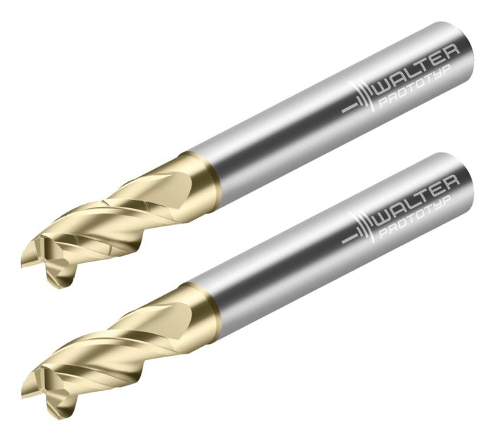

WAL-585 Walter MA263 (top) with chip-splitter geometry. Walter MA267 without chip-splitter below.
Available in diameters from 1/8″ to 1″, the MA267/MA263 Advance tools are excellent for machining all other ISO N materials, such as copper, brass, bronze and magnesium-based alloys, in addition to aluminum. With a cylindrical shank, these tools are available with or without chip-splitters.
The WJ30UU grade for the MA267/MA263 tools is uncoated, and the WJ30CD grade features a wear-resistant zirconium nitride (ZrN) coating to achieve maximum productivity and tool life. The MA263 with chip breaker geometry reduces cutting pressure and vibration at high feed rates. Both versions offer end geometry that is designed for aggressive ramping.
Benefits include imparting consistently fine surface finishes throughout the entire tool life, polish grinds to generate superior surface finishes on both walls and floors, and a polished flute face that optimizes chip evacuation.
Walter also developed the MA268 to machine all ISO N materials at the highest level. The solid carbide milling cutter has a 39° helix and is available from 1/4″ to 1″ in diameter. The tool has a cylindrical shank and is available with a standard or reduced neck. The MA268 is also offered in the uncoated WJ30UU grade and the WJ30CD grade with the reliable ZrN coating. The cutter’s unique geometry reduces cutting pressures and vibration at high feed rates. The highly polished OD and flute face prevents chip build-up. Knuckles, or the serrated cutting edges, shorten the chip length to aid chip evacuation and reduce tool pressure.
