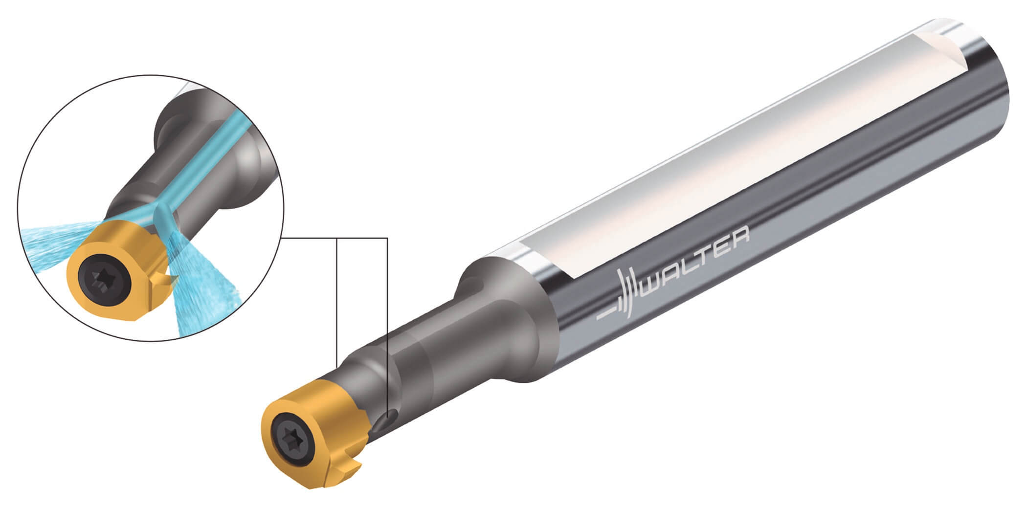

Greer, SC—New WE “Exchangeable” heads and W3270/W3271 boring bars from Walter enable repeatable high-quality machining to minimize the rejection rate and maximize tool life due to the precision ground and sharp cutting edge. A large standard range is available, as well as specials with a short delivery time.
The WE head is for internal machining from 0.276 in. (7 mm) in diameter and axial grooving from 0.472 in (12 mm) in diameter. The WE positive engagement with three contact surfaces provides a high level of process reliability, stability and accuracy. The tool maximizes flexibility due to the ability to replace the WE head in the same toolholder (from a Dmin of 0.276 in.).

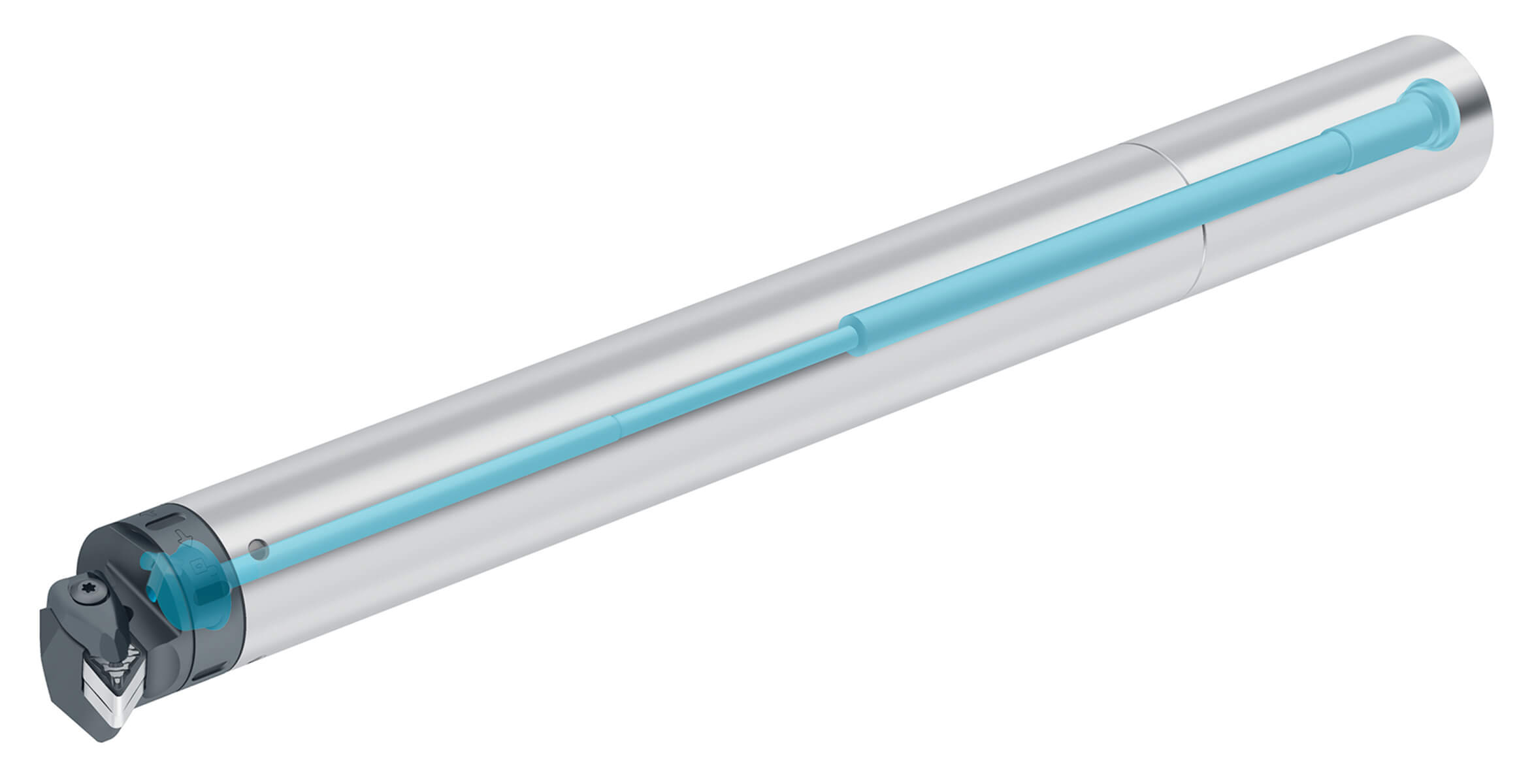

The W3270/W3271 boring bars are available in 12-16-mm and 0.5-0.625 in. with clamping surface in steel and carbide. For universal applicability, the coolant outlet is on both sides for the W3270 radial boring bars. Rake face cooling and an additional flushing hole enable a high-volume flow. The W3271 axial boring bars are handed (right hand/left hand) and have the coolant outlet either on the right- or left-hand side of the bar optimized for the most efficient cooling.
