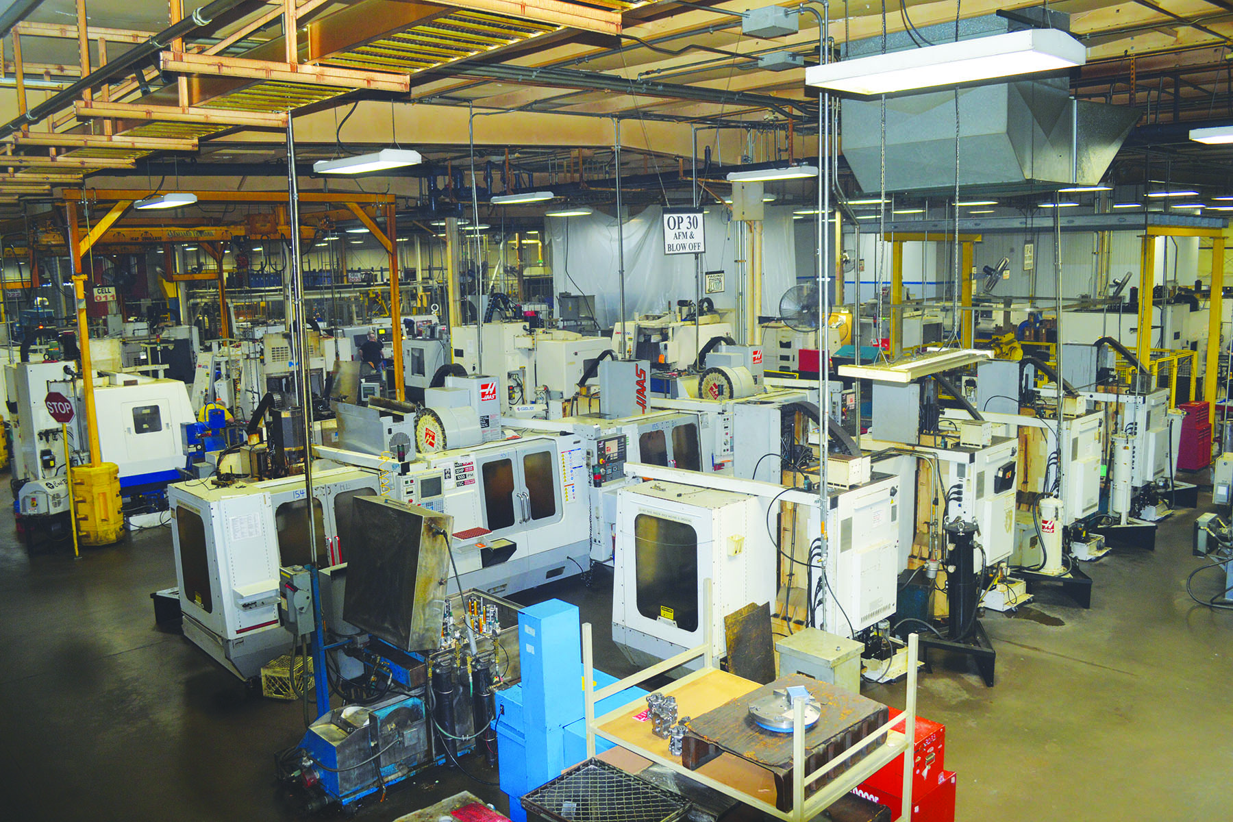

Mennie Machine 250,000 sq.ft. facility includes the latest in machining technologies.

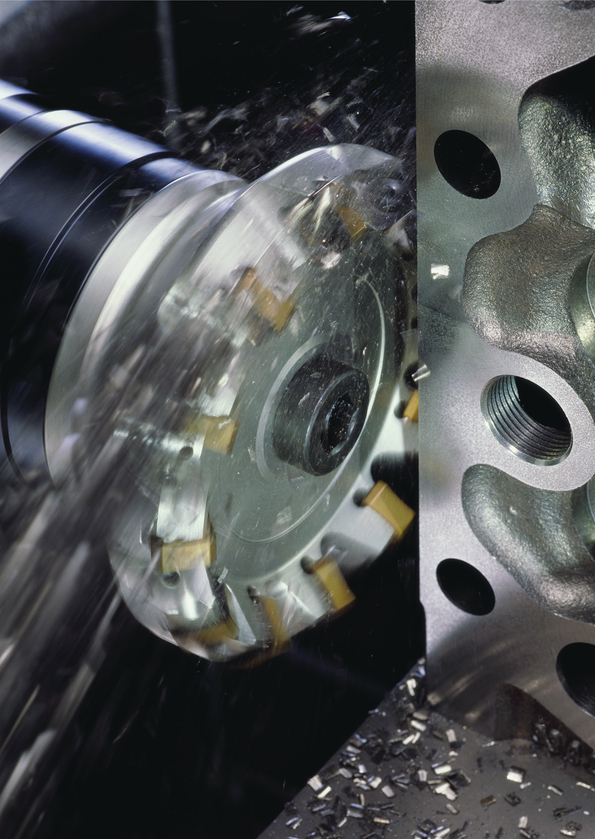

Project implementation began in early 2016. Speaking of the initial runoff, Cimei recalls that “We quickly knew after the first couple of hundred pieces were run that the project was a success.” The implementation started with rough milling. The rough face milling parameters were overhauled with testing-determined, optimized tool geometry, the latest carbide and insert coating technology from Walter was employed and the desired chip formation was achieved. In addition, improved tool paths to eliminate inefficient motions, reducing cycle times and improving tool life, were instituted. Because of these actions cutting time for rough face milling was reduced from 52.6 seconds to 22.4 seconds.
Finish face milling was next to be addressed. New cutting parameters were instituted, parameters determined to provide the fastest cutting without sacrificing surface quality. Tooling was switched to the latest carbide and insert coating technology from Walter. Because of these actions cutting time for finish face milling was reduced from 174.0 seconds to 152.0 seconds.
