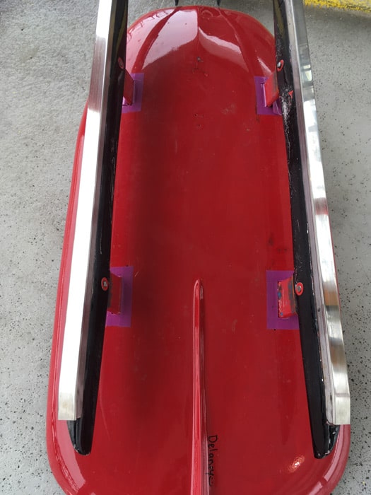

The steels, shown here on the underside of the luge, are waterjet-cut to within tight tolerances, then finished and tailored for each luge athlete.

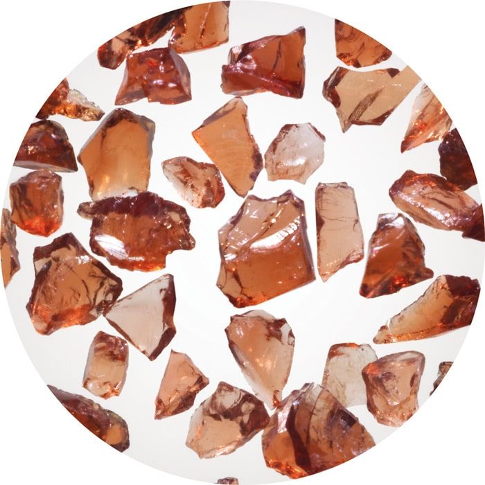

The ADIRONDACK HPX garnet Accurate Waterjet uses for its USA Luge work has a crystalline structure with sharp, angular edges.

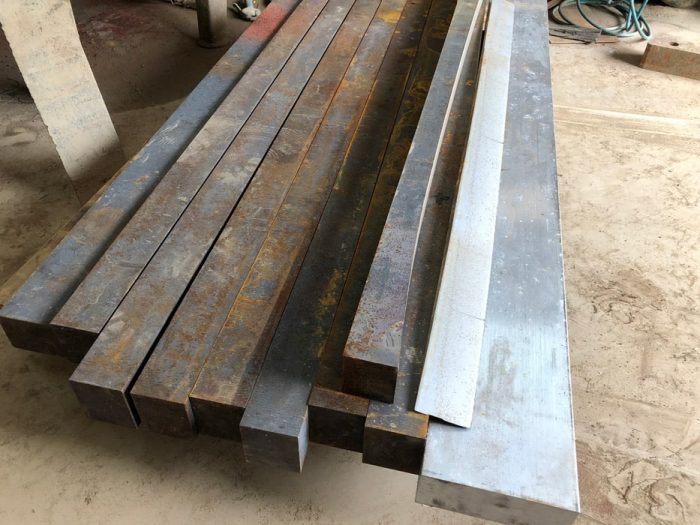

The raw material for the luge steels comes in bars. These bars are staged and ready to be cut on the waterjet.

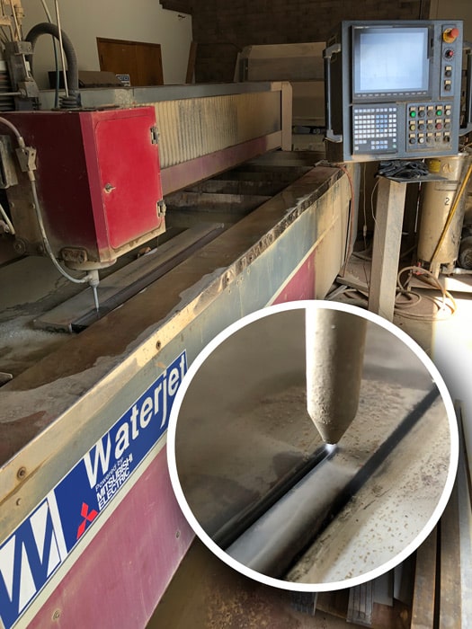

For the latest generation of steels, Lytle relied on a Mitsubishi waterjet machine with a KMT intensifier pump that produced a maximum of 90,000 PSI of water pressure, though 70,000 PSI happened to be the most efficient for cutting the steels. The machine has a 0.010-in.-diameter orifice with a 0.030-in.-diameter mixing tube, which fed abrasive at a rate of 1 lb. per minute.

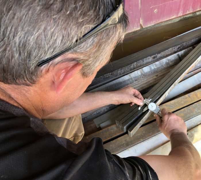

An operator at Accurate Waterjet inspects a cut runner.

In the past luge steels comprised several pieces, including a separate edge material that was bonded to a base metal for the main part of the runners. The shop had cut the edge material using a Barton 80 HPA garnet, but this year’s one-piece steels called for an entirely new process and another type of garnet, Barton ADIRONDACK® 80 HPX®.
The brand name comes from where it’s mined, from Ruby Mountain in the Adirondacks of upstate New York, not far from Lake Placid, where USA Luge is based. In support of USA Luge, Barton donated the garnet used to create the latest one-piece steels. “We are excited to participate in this effort,” said Randy Rapple, president of Glen Falls, N.Y.-based Barton International, “and we look forward to seeing the team compete in Beijing.”
As Lytle explained, the HPX garnet has sharper edges than HPA, so it’s more suited to demanding applications. Wet processing during abrasive manufacturing removes fine materials within the garnet, which reduces the dust during the waterjet process and produces a clean cut.
“With the luge steels, we have a tolerance of ±0.010 in. through 2 in. of steel material,” Lytle explained, adding the garnet’s sharp edges “cut with less taper, allowing us to hold these tight quality requirements.”
Lytle added that the sharp edges give the garnet aggressive cutting characteristics, which helps boost cutting speed, in this case by about 10 percent, while still maintaining a high edge quality.

Luge runners are cut on a waterjet system using 70,000 PSI of water pressure.
