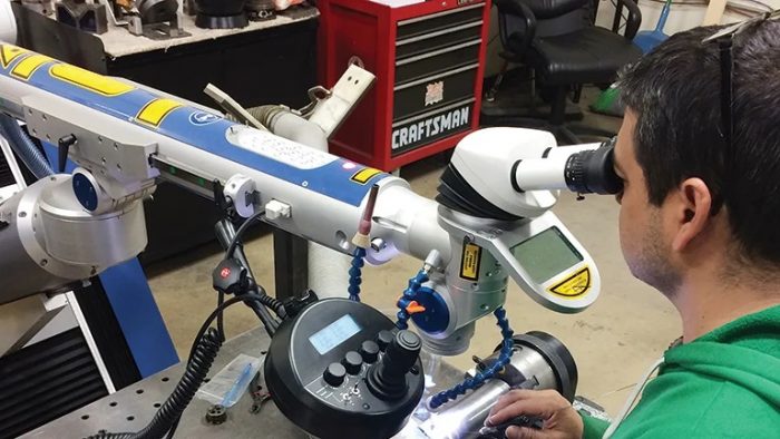

More job shops are taking the plunge and acquiring laser welding systems—generally when suitable applications come through their door or when seeking to replace MIG and TIG welding.
“People are really jumping into laser head first these days,” said Wes Wheeler, sales manager of Alpha Laser, Meadville, Pa. “Laser welding has traditionally been driven by repair processes, such as tooling repair and high-value repairs. As lasers become more efficient, people are starting to use them for production welding.”

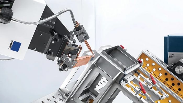

A relatively new concept continuing to gain traction is the range of beam-in-beam laser processing systems. Trumpf, a pioneer of the technology, offers two such solutions: BrightLine Weld from its laser technology division, and FusionLine from its machine tool business. The ring technology and single fiber are available for use on the TruLaser Weld 5000, introduced about three years ago.
Ryba noted that by using the inner core and outer ring beams simultaneously, spatter is greatly reduced. This increases longevity of tooling and fixtures and reduces the need for cleaning of protective cover slides—meaning more uptime. More importantly, welding speed and quality are increased, especially for aluminum and copper.
On copper, the outer ring acts like a preheating effect, allowing better coupling of the core beam. This provides a stable welding process, especially at slower speeds, allowing deep penetrating welds and a spatter reduction of 70–85 percent. By preheating copper before the weld, BrightLine is about 10 times faster than a single-spot beam, he said. With aluminum, spatter can be greatly reduced—and speed increased. “I can raise power to 5 kW and increase welding almost 7X to approximately 35 meters a minute” depending on aluminum grade, said Ryba. “Press fits and butt welds work well, and on steel you can weld three times faster with the same amount of power. On aluminum to copper you get a much better quality weld.”
BrightLine’s cores are adjustable in one percent power increments, Ryba explained, up to a maximum of 90 percent for one beam and 10 percent for the other. Operators can also switch from core to core at 100 percent strength. All power distribution adjustments are made in a window in the TruControl software.

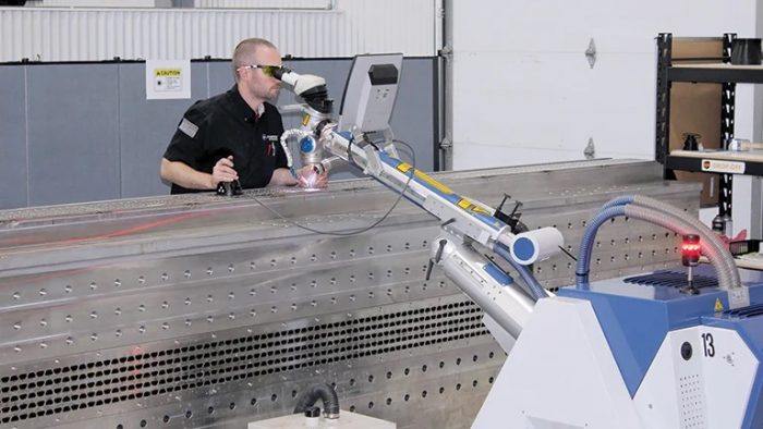

For shops doing repairs and production work, the flexibility of pulsed welding has been attractive thanks to its ability to limit heat input. Pulsed welding “is a forgiving process,” explained Alpha Laser’s Wheeler. “Traditionally, a continuous wave laser wants to get penetration; a pulsed laser can still get penetration but can also be used to get almost no penetration.” Alpha Laser systems—including its ALFlak series—range in pulse time from 1 to 20 ms, with the normal range being 5 to 7 ms.
Alpha Lasers says its pulsed fiber and YAG lasers excel at providing low penetration levels and low dilution rates—the mix between base material and added filler. In one example comparing pulsed laser to a TIG process, Wheeler noted, the laser performed a 0.055″ (1.40-mm) weld deposit with a heat affected zone of only 0.008″ (0.20 mm) below the weld, and a weld dilution zone of about 0.006″ (0.15 mm). “This was a test for a customer who didn’t understand when I explained that laser had lower heat input,” he recalled. “They asked what was wrong with TIG welding, and I said, ‘Let me explain what you’re doing to your base metal.’ ”
Experienced laser welders and multiple machines are essential to keep up with repair demand.
In terms of expanding fabricators’ appreciation of the benefits of pulsed welding, Wheeler emphasizes material flexibility. “We’ve done everything from copper to stainless joining,” he explained. With a beryllium copper base, “we put stainless steel on it all the time. We’ve worked with all the high-end metals, superalloys like Inconel and Stellites, and cast iron. The normal world for us is traditionally tool steels. One of the big applications we see is working with any kind of stainless, especially 300 series stainless, which is easy to warp and works really well with a laser.”
In terms of replacing TIG welding setups, a recent Alpha Laser system that was sold to a major company’s switch and control division has dramatically decreased scrap rates, from 15 to 3 percent, Wheeler added. That rate “should be even lower if we can get it perfect. It’s going to provide a ton of value, with less work before and after—no preheating or postprocessing—and should decrease overall cycle time significantly.” Another application in the paper industry is welding a component 30′ (9.14-m) long with 6,000 tubes inside. There is even some talk of a single pulsed laser system being able to replace a pair of brazing lines.
