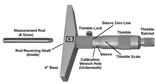

Anatomy of a depth micrometer
depth micrometer
Image credit: chicagobrand.com
The two main parts that differentiate depth mics from outside mics are the flat base attached to the sleeve and the measurement rod. The flat base stabilizes the mic on the top surface of the recessed part. The measurement rod typically has a small diameter to facilitate the measurement of small holes or slots. Measurement rods come in different sizes and are interchangeable to allow the measurement of multiple depths.
Just like any other mic, depth micrometers feature a scale on the sleeve that shows the depth measurement. Unlike traditional mics, zero is located toward the end of the thimble. The measurement is read in reverse and increases as the thimble moves toward the base of the instrument.

First, you’ll want to select the right rod size (which depends on the depth of the recessed area you are trying to measure). Next, clean the mounting surfaces of the measurement rod and the rod-receiving shaft. Insert and rotate the measurement rod into the rod-receiving shaft to seat it completely. Then, turn the thimble counterclockwise so that when the base is flat on the top surface, the measurement rod does not touch the surface to be measured. Holding the base firmly on the reference surface, rotate the thimble ratchet clockwise until the rod stops on the measurement surface and the mic clicks three times. Once that is complete, simply, read the depth measurement.
How to calibrate a depth micrometer
Although depth micrometers tend to stay calibrated, it’s always a good idea to check your instrument before using it. The calibration process for this particular style of mic is quite simple.
All you have to do is roll the 0-1”rod all the way up into the base of the tool, place the base on a flat surface and turn the thimble ratchet clockwise until the measurement rod tip is stopped by the flat surface and the ratchet click” three times. The sleeve zero line should line up with the zero on the thimble scale. If they are not aligned, position the tip of the calibration wrench in the calibration wrench hole on the sleeve and rotate the sleeve to achieve alignment.

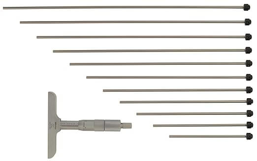

Starrett 440Z-6RL Vernier Depth Gauge
ORDER NOW
This complete set comes with 12 interchangeable rods that allow you to measure depths up to 12”. It comes with a ring-type knurled lock nut, ratchet as well as a speeder for stability and to apply uniform pressure and make quick adjustments for precise measurements.
