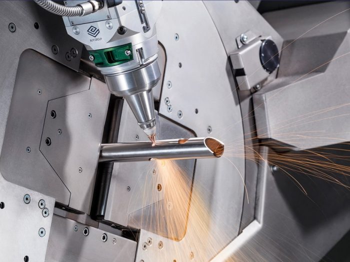

When fabricators think about fiber laser cutting technology, they might think of high-speed cutting first. That might be true, but when it comes to tube cutting, speed is relative. It’s more about the time it takes to process a tube to meet specifications than actual cutting speed on the tube. Photos courtesy of BLM Group USA Corp.
Some things aren’t quite as evident until you take a closer look at a fiber laser in operation. Because its beam diameter is often one-third the size of a CO2 beam, a fiber laser has a greater power density than a CO2 laser beam. Not only does this allow the fiber to cut faster, but it also allows it to pierce faster. This smaller beam size also gives the fiber the ability to cut intricate shapes and leave sharp edges. Imagine cutting a company logo out of a tube when the spacing between the logo’s letters is 0.035 inch; a fiber can make that cut, while a CO2 laser can’t.

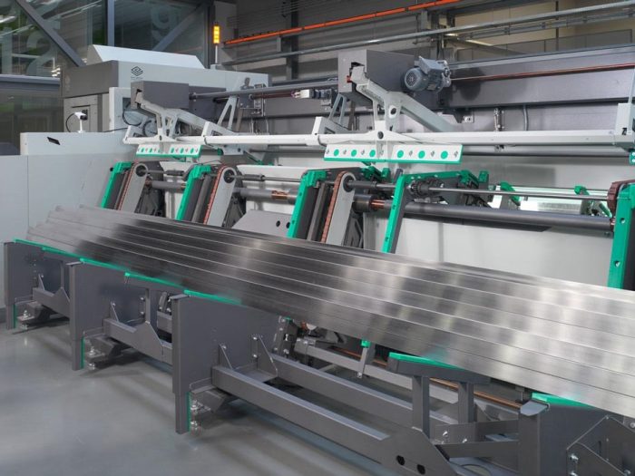

There are no standard material towers with a laser tube cutting machine. Bundle loaders, the most efficient of the tube material handling options, feed one tube at a time from the bundle into the tube laser via a singularizing system. This type of feeding mechanism doesn’t work with open profiles, such as angles or channels, because they interlock while in a bundle and don’t come free easily. For open profiles, step loaders are used, which sequence a section one at a time into the machine while keeping the correct orientation of that section.
These tubes are not small. In the U.S. standard lengths are 24 feet. Some on the West Coast typically work with 20-ft. lengths as standard sizes.
Variety is the reality of any job shop, and the same goes for those that operate a tube laser. It’s not unusual to see parts of various sizes come from one tube. The machine must be able to unload laser-cut parts that may be as small as 2 in. and as long as 15 ft., one right after the other. It also must be able to unload those parts without damaging them, which can be a challenge with softer metals such as aluminum.

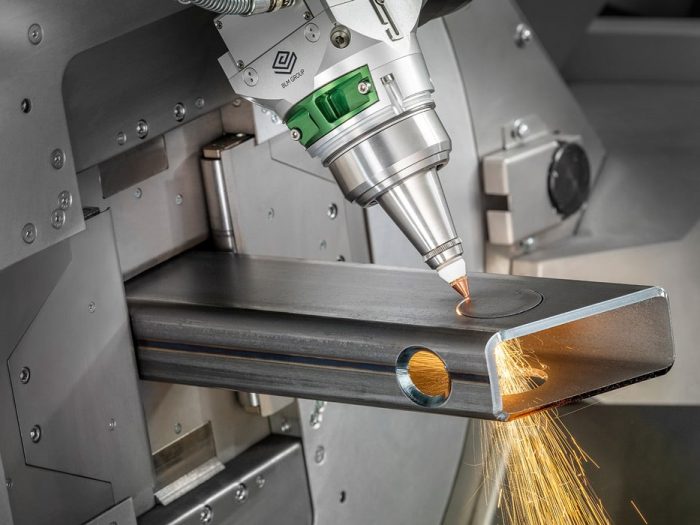

The very nature of a tube prevents the need for a machine with a very high-powered laser. Whereas flat sheet laser cutting machines now are available with laser generators as powerful as 12 kW, tube laser cutting machines usually only require a maximum of 5 kW of power. With a tube, you always have to think about the opposite side of the tube you are cutting. A more powerful laser simply would blow through the other side of the tube during cutting. (Of course, if you are processing a beam or a channel on the tube laser you don’t have to worry about another side.)
Another consideration in tube cutting is the weld seam. This material is roll-formed and welded together. This brings up two points that typically must be addressed:
1. The positioning of the tube’s weld seam has to be taken into account for laser cutting. The weld seam must not interfere with pins or holes, and for aesthetic applications, such as furniture, the weld seams need to be hidden as much as possible. In a conventional laser tube cutting system, an optical sensor is used to scan the tube to look for the weld seam. Often tubing is covered in oil or rust, and the weld seam can be difficult to differentiate from other surface areas with contaminants. On stainless or galvanized, the weld seam may only be visible internally. That has led some manufacturers to incorporate cameras in their systems that allow the machines to not only scan the outside of the tube, but also internally as well. This allows the machine to detect that obscured weld seam and correctly position the parts in respect to it.
2. The weld seams also are of different compositions and cut differently than the rest of your tube. Traditionally, operators had to slow down or increase power on all operations that occurred on a tube to account for the weld seam. Today some OEMs have developed their control technology and parameters to allow the machine to single out a weld seam and adjust only those sections. This lets the machine process those parts in the fastest way. The control automatically adjusts the power, frequency, and duty cycle as the laser works its way through the tube—and its weld seam. The operator doesn’t have to create perfect parameters; he can focus on getting material in and out of the machine.
